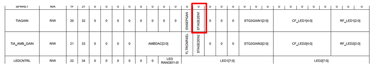

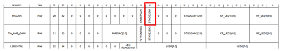

hi sir,
I found that ambient cancellation current setting only affects LED2's result (LED2VAL). when I change AMBDAC[3:0], LED2VAL's DC value changes but LED1VAL's DC value not change anyway. Why ? Registers setting as below:

AVE4+TIMEREN , // 1E Control Register 1
0x0 , // 1F SPARE1 for future use
RF_100K+CF_250p+SEPGAIN_EN, // 20 enable seperate gain mode (for ir LED)
RF_100K+CF_250p+STG2GAIN2+STG2_EN, // 21 TIA_AMB_GAIN register(for red LED)
0x3030 , // 22 LED Control Register
BIT9 , // 23 Control Register 2
0x0 , // 24 SPARE2 for future use
0x0 , // 25 SPARE3 for future use
0x0 , // 26 SPARE4 for future use
0x0 , // 27 RESERVED1 for factory use
0x0 , // 28 RESERVED2 for factory use
0x0 , // 29 Alarm Register
0x0 , // 2A LED2 Digital Sample Value Register
0x0 , // 2B Ambient LED2 Digital Sample Value Register
0x0 , // 2C LED1 Digital Sample Value Register
0x0 , // 2D Ambient LED1 Digital Sample Value Register
0x0 , // 2E LED2-Ambient LED2 Digital Sample Value Register
0x0 , // 2F LED1-Ambient LED1 Digital Sample Value Register
0x0 // 30 Diagnostics Flag Register
