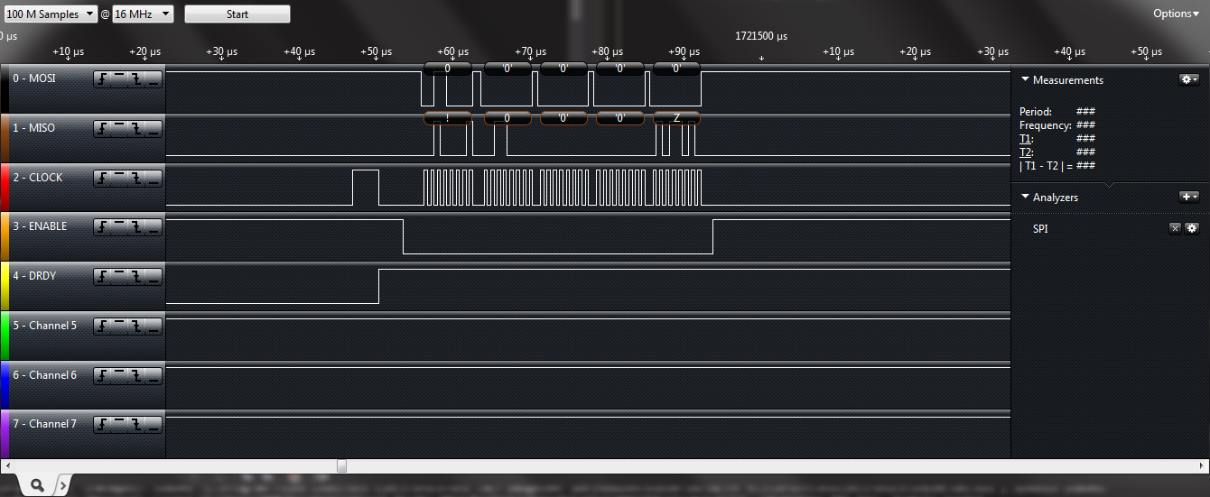

I wanted to remove the MMB0 and use only the EVM itself but somehow I SPI communication goes wrong. When I am trying to read the OFFSET value for example the StatusByte.ChannelID never returns the right ID. Lets call this error ChannelIDMissmatch. Well I decided to use a logic analyzer from SALEAE to see whats going on.
And here is my experimental result:
Register Type: ADC.Registers.SysRed Value:   0x3D Default Value: 0x00
Register Type: ADC.Registers.MuxSg0 Value:   0x00 Default Value: 0xFF
Register Type: ADC.MuxSg1 Value:                      0x00 Default Value: 0xFF
Register Type: ADC.MuxDif Value:                        0x00 Default Value: 0x00
As you can see, the registers are configured to read only internal values.

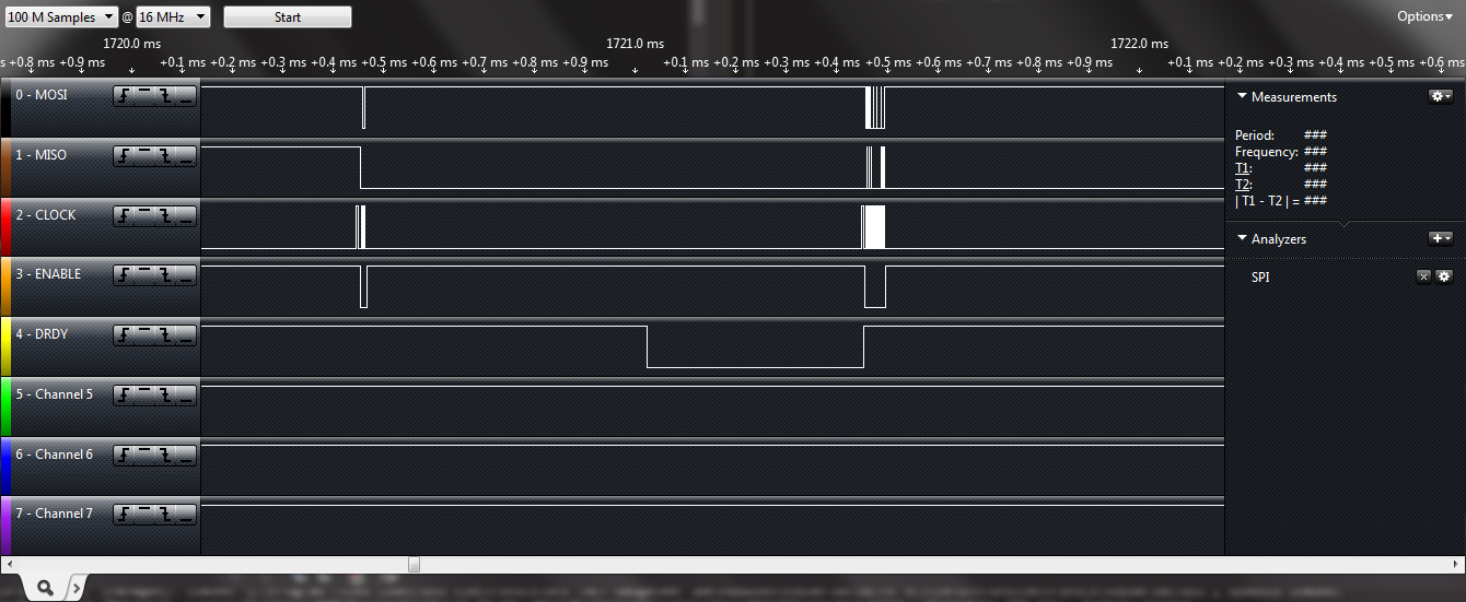

Sending out the PulseConvertCommand:
The entire communication: with DRDY

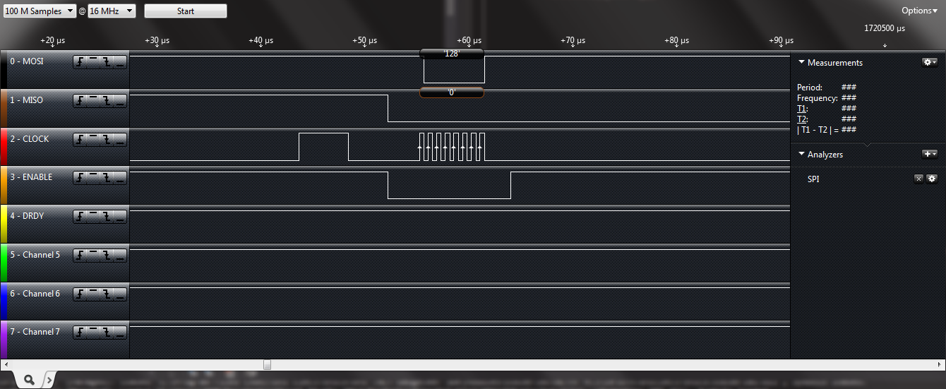

and Only the response with Wrong ChannelID Response:
As you can see the '!' and Z indicates invalid data...

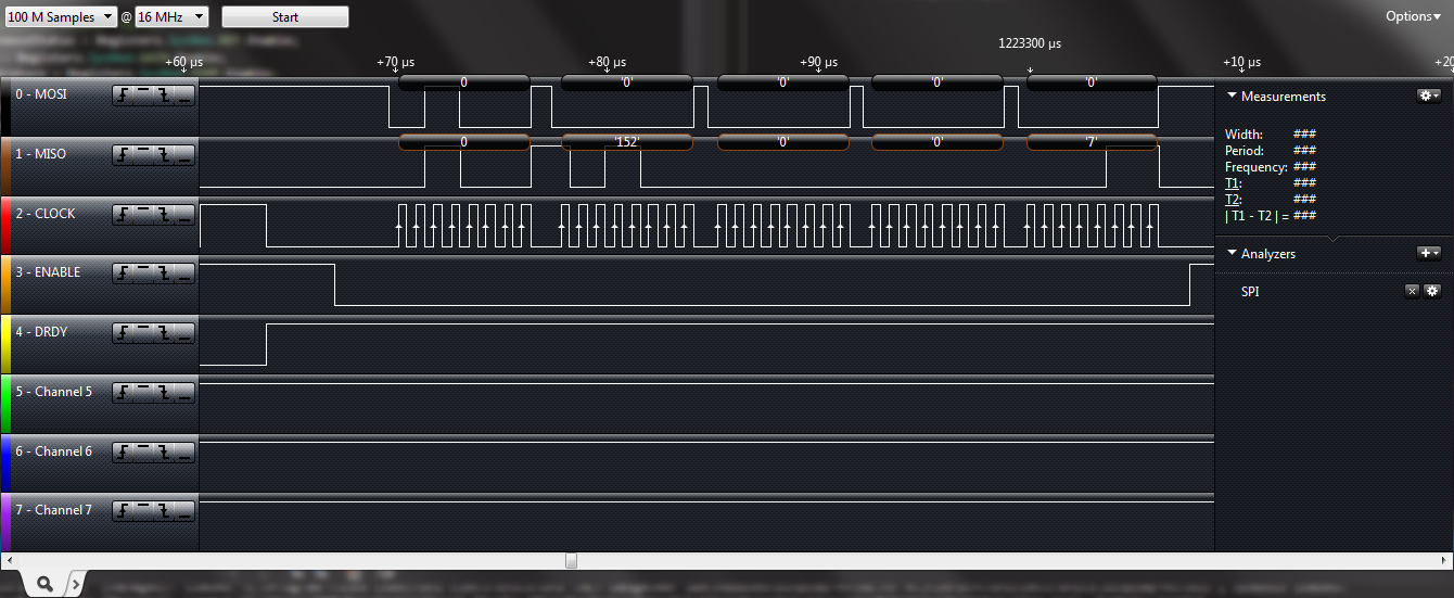

I have reconnected the MMB0 and made another trial. Here is the result with the good outcome.
The value 152 equals to the value read from the ADS.

    I recommend keeping them set to their default values, but adding a jumper to connect J4.13 and J4.14, so that the analog and digital grounds are properly referenced to each other.
    Your "J5.6 to J6.4" connection should being doing the same thing, but if it is a jumper wire, it will not be a short connection and could be disturbing your digital communication.
    If you still have communication issues, try probing the digital pins on the ADS1258 with and without the MMB0 to see if one of the signals (such as START) is changing states. The EVM should have pull-up and pull-down resistors to set all of these signals correctly; however, with the MMB0 connected (and un-powered) we cannot be sure of the state of those signals.

    For prototyping you may have to use breadboards and jumper wire. It is important to be aware that for precision analog circuits or high-speed digital communication, the parasitic impedance introduced into your circuit (whether prototyping or the final PCB) can create problems such as distorting digital signals.
    The problem I think you are seeing is a large inductive impedance on the digital ground connection to the ADS1258. (While the Saleae is a nice tool, it doesn't show the whole picture. Try probing your digital signals with an oscilloscope and see how noisy they appear.)
    A PCB has the advantage that you can place a ground plane on the second layer (i.e. very close to the signal carrying trace). This keeps the loop area very small (that is the loop area of the signal and it's return current). Small loop area = small inductance (and less inductive noise coupling from nearby circuits).
    If you ever use jumper wire to connect between two boards, try creating a twisted pair cable with the signal wire and a ground wire to keep the loop area small.
