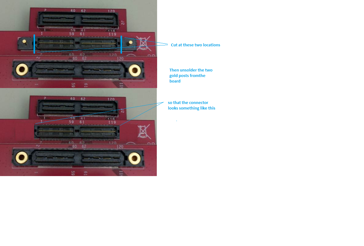

I've got a DAC34SH84EVM Rev. D and a FMC-DAC-Adapter Rev. D which I'd like to connect.
On both sides of the socket on the DAC-Board there is a metal pin, that doesn't fit through the Adapter-Board's holes, so... what am I doing wrong?

Dear Jim,
thank you for your answer. Is there any FMC-DAC-Adapter revision that has these locking Samtec connectors? If possible, I'd like to not cut down a newly buyed adapter board. If there is no other option, I would do the cutting by myself.
