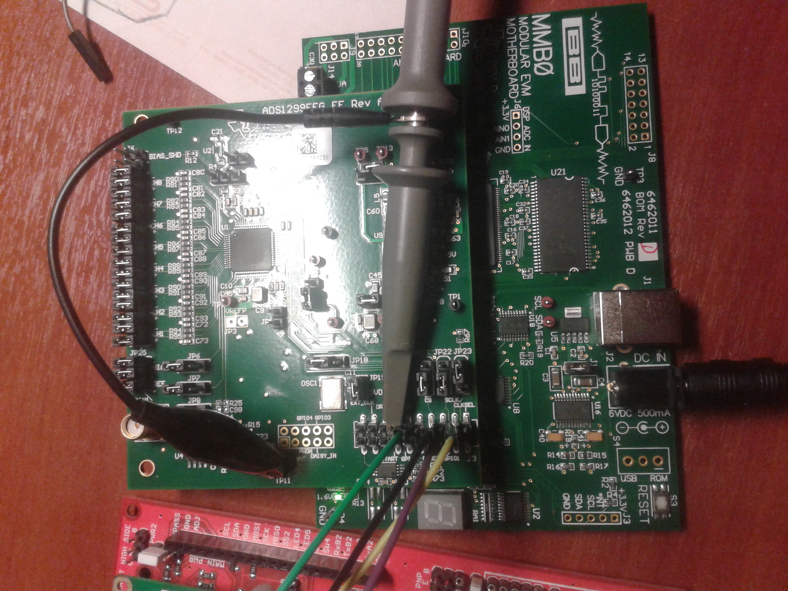

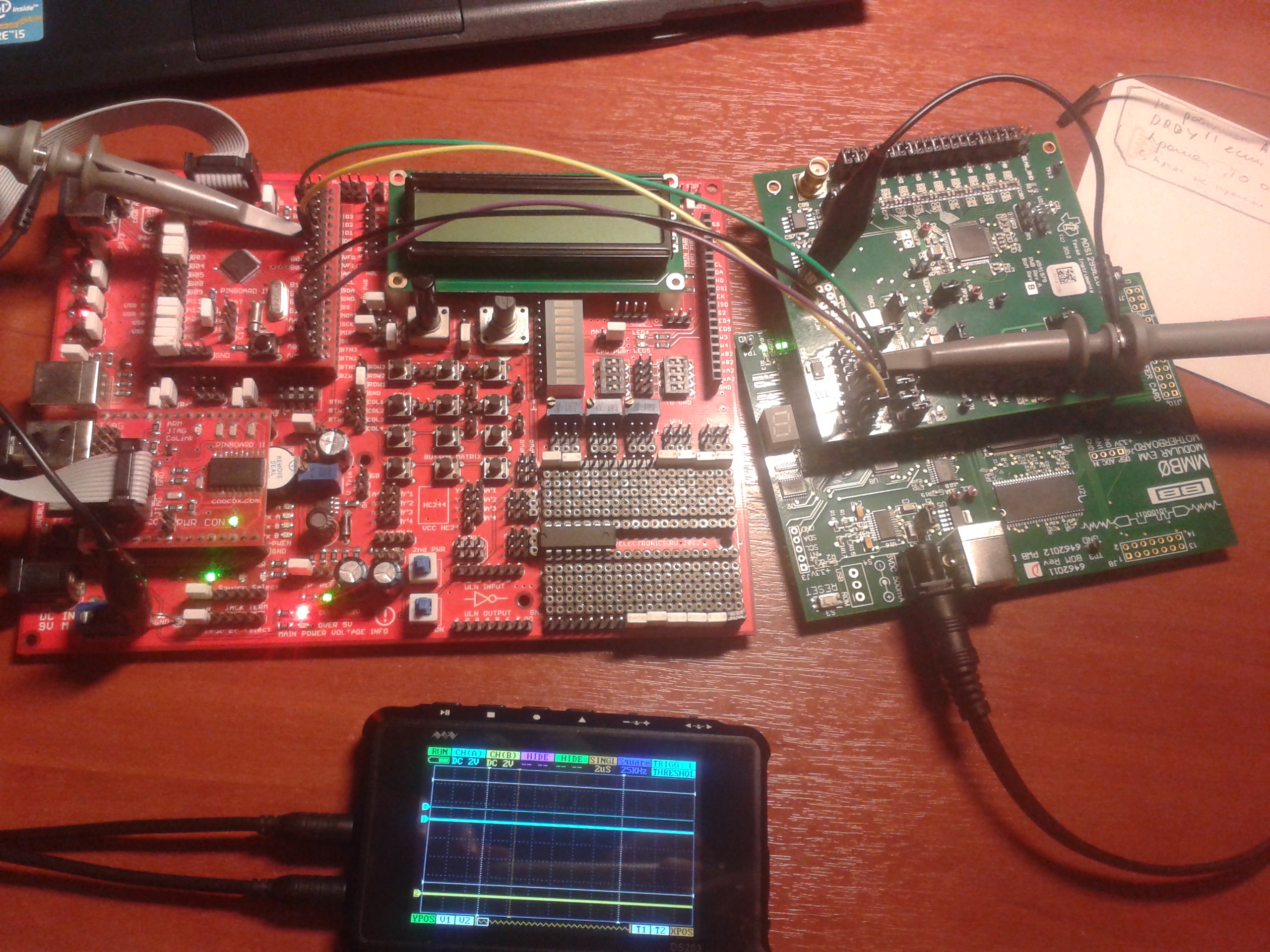

Hi!
I plugged the board with STM32 microcontroller to the board with ads1299. Board MMB0 use for power. SPI configuration: CPOL = 0, CPHA = 1, 16-bit. As I understand it, as soon as power ads1299 starts conversion and DRDY sends impulses. I send a command SDATATC and check DRDY - pulses continue to go, ie SDATAC command failed
All signals are checked directly at the inputs of circuits ads1299. Please help me understand what I'm doing wrong. Thank you very much!

  • Hello mysol93,
    Sorry it took us so long to respond! The SDATAC command will not stop conversions, it simply stops the device from outputting data automatically with a toggling SCLK. Data may still be read synchronously in SDATAC mode using the RDATA command.
