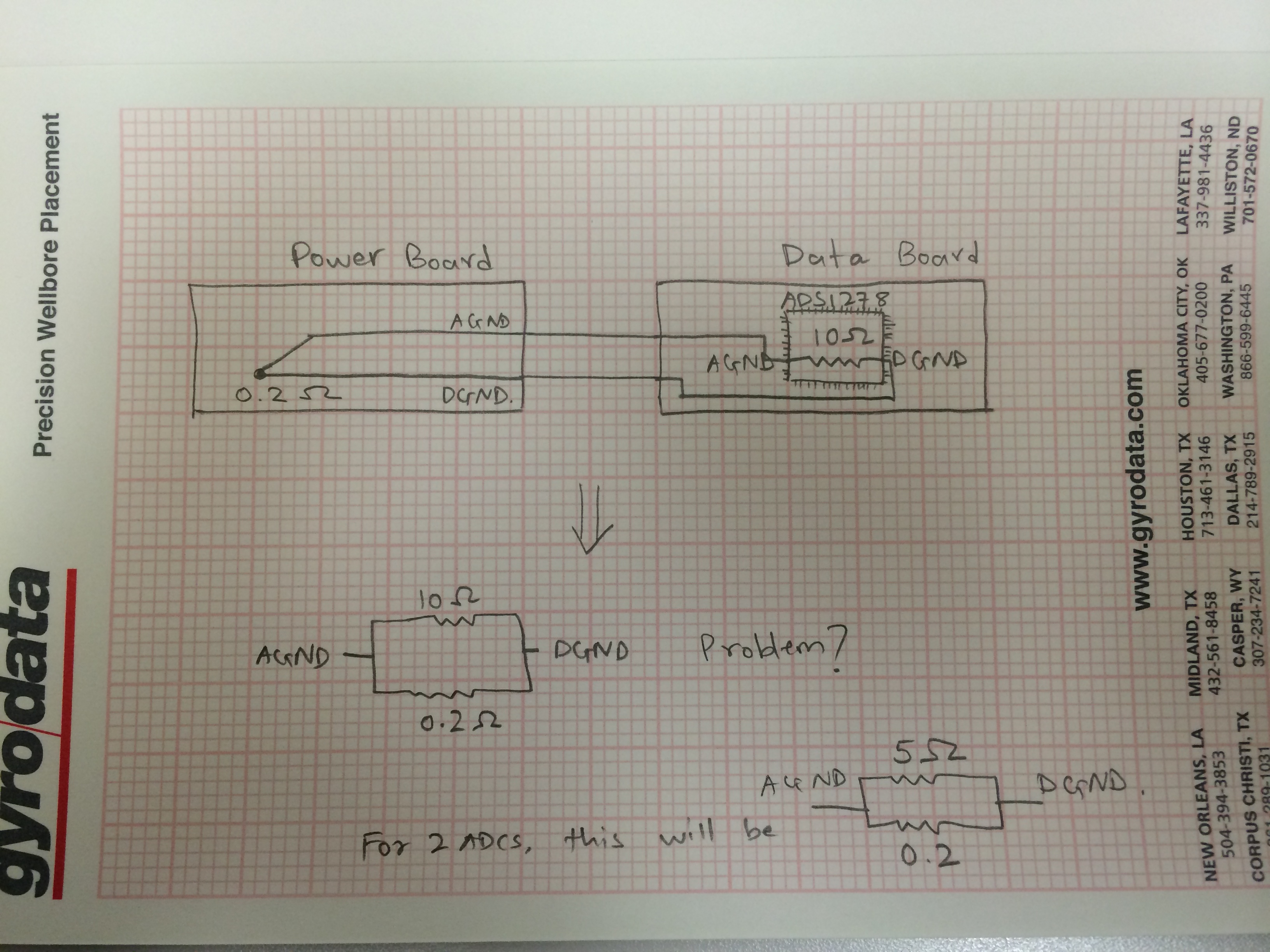

I had posted a question earlier about my concerns with the grounding on the ADS1278 chip. What I have found is that one of the designated AGND pins, 58 has a low impedance connection to the DGND pins 21,24,25. It measures out to be only 10ohms. Why would this be?

    The 10ohms I measured is on a free standing chip without any connections.
    Yes I have the AGND and DGND connection outside this board and so this 10 ohms is posing a problem in my system. I would like to have only one single AGND-DGND connection.
    Can I leave pin 58 open? I did get 0.5Mohms when I lifted pin 58 off its pad.

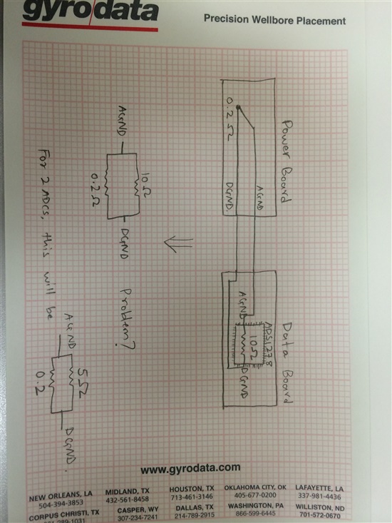

  • Hi Ryan,
    I am not sure if you read my reply earlier, so what I am trying to say is that the layout is not in question at all. Just take an ADS1278 chip from a reel/tray, no connections. Put it on your bench and ohm the pin 58 (AGND) and either of the pins 22, 24, 25 (DGND). You will see 10 ohms.
    I have a concern regarding this 10 ohms coming from the chip. Does it create a loop between AGND-DGND connections by the ADC (10 ohms) and the system where they are actually shorted (0.2ohms). Please see the attached file to get a better idea.
  • Hi Yashas,
    Thank you for the diagram, this makes more sense to me now.
    I honestly do not know where the 10 Ohms is coming from, let me ask the designers if this is reasonable to expect.
    Even with the 10 Ohms, the parallel combination of the two impedances is ~ 0.19 Ohms. This should be OK as long as the potential between AGND and DGND does not exceed +/- 300mV.

  • Hi Yashas,
    The impedance that you are measuring between AGND and DGND may exist because back-to-back diodes were placed in between to tie them together. If you are measuring with a multi-meter, you should see a different impedance between the two pins when you reverse the Red and Black leads. Basically, this means that the low impedance you measured is expected as part of the chip design and cannot be avoided. Do not lift the pins off of the PCB.
    That said, you are correct that having internal and external connections between AGND and DGND will form a ground loop, which best practices generally tell us to avoid. The best we can do is to externally short AGND and DGND directly beneath or close to the device. Then, you can mitigate the effect of the ground loop by only bringing one connection from the Data Board over to your Power Board (use the AGND connection). The thermal pad on the ADS1278 should also be tied to AGND.
