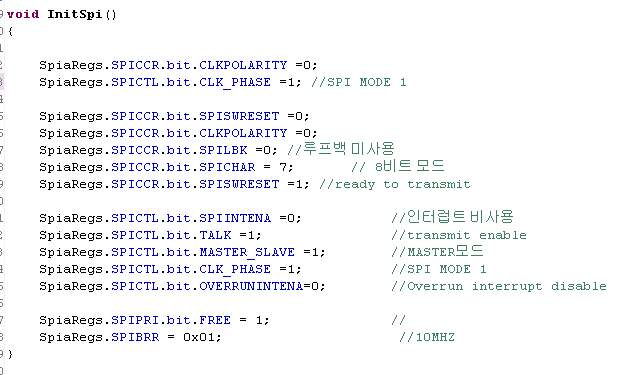

I am using SPICLK(rising edge with delay)
I
I am working for using DAC8760 with TMS230F28335
but DAC8760 not operated
I don`t know why DAC8760 not operated.

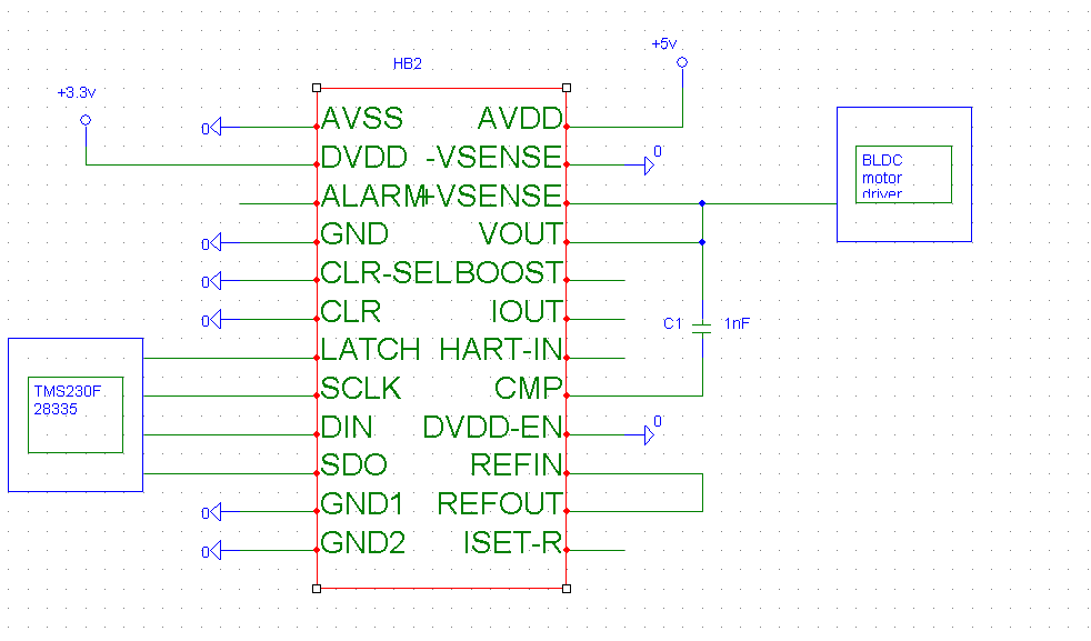

DAC8760 pin connect(TSSOP-24) : only using Vout
1. AVSS : gnd
2. DVDD : 3.3V
7~10 : connected 28835
11,12 : gnd
14,15 : connect each other
16:gnd
17,21 : 17-----------1nF-------------21 connect
21,22 : connect
23 :connect
24:5V
if I did a incorrect work, i hope you know correct method using DAC8760

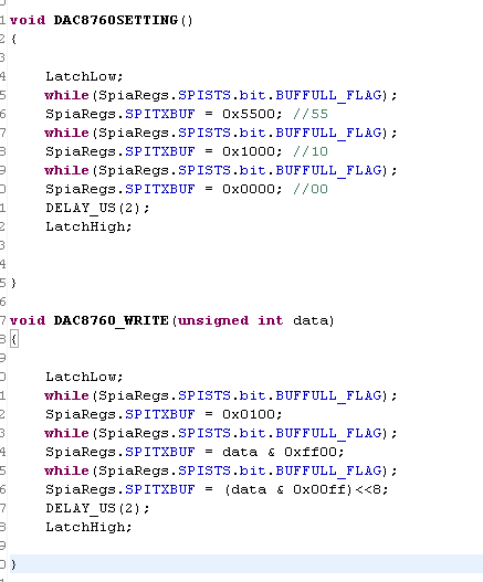

below DSP code
  • Kang,

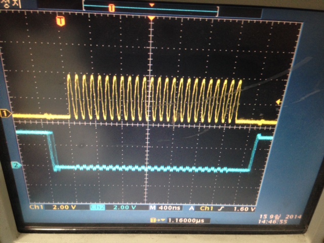

    You clock phase and polarity settings are correct. The protocol you are implementing to communicate with the device also looks correct, both in code and in the oscilloscope captures you have provided. There is considerable ringing and cross-talk in your SPI signals but I do not think that is the cause of this issue.
    It would be helpful if you could provide a schematic to double check your hardware rather than words describing the connections in the design.
    In the oscilloscope capture you provided you are writing address byte 0x01 with data 0xFFFF, which corresponds to writing full-scale data to the DAC Data register. Is this the complete write sequence that you are using to test communication with the device?
    schematic include
     you say I am writing adreess  byte 0x01 with data 0xFFFF
    becasue TMS230F28335 has SPI with sending 16bit
    but DAC8760 has 24bit adresss
    so I am sending each 8bit
    and I checked sending correct data by osciloscope
    and is it right including schematic??

    Understood - we discussed the format you are using to communicate with the device in a previous E2E thread. The method you are using to communicate with the device looks good in both code and in the oscilloscope captures that you provided.
    The oscilloscope capture you provided writes the 24-bit word 0x01FFFF which writes full-scale to the DAC Data Register. If this is the only write that you perform I would not expect for the device to respond in any way because neither the voltage or current outputs are enabled. In order to enable the analog outputs you need to write a '1' to bit 12 in the Control Register (address 0x55). With the outputs active you should see the voltage or current output respond to data placed in the DAC Data Register. The output mode that is active is set by the RANGE bits in the Control Register.

    Functionally the schematic looks okay. There are several off-page connectors that make some details difficult to access. I would suggest that decoupling capacitors are included on AVDD and DVDD. A small decoupling cap should also be included on the REFIN to REFOUT connection.

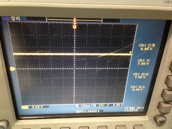

  • I am solved.
    problem didnt connect analoge and digital with seperated
    but problem appear.too
    as you see, even though I am setting 0~5V range in control register
    but this picture show Vout is 300mV~7V
    so I did set gain register and zero register..
    but DAC8760 is still showing 300mV~7V

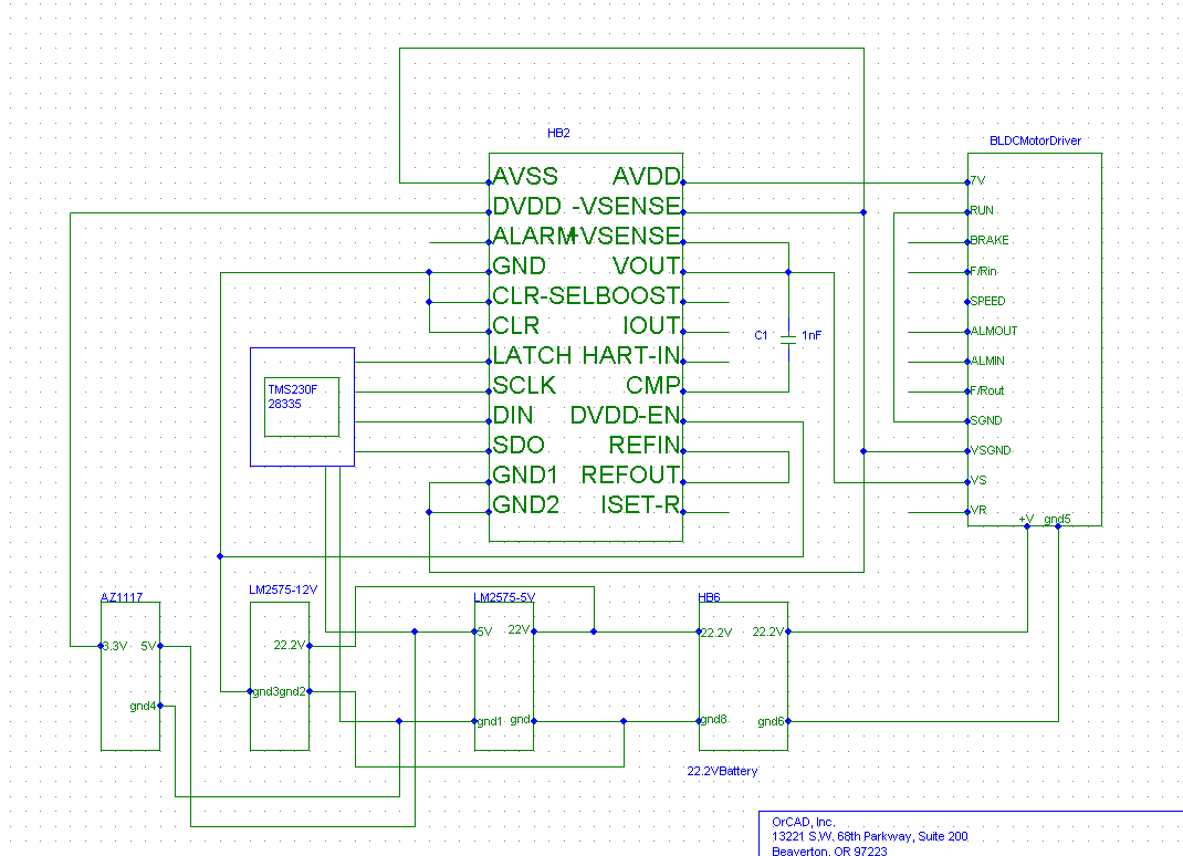

    Can you provide a full-schematic of the board you are using to make these measurements? If you could share the layout as well that would be helpful. I'd like to also know exactly where you are making the measurement as well (Where is the oscilloscope lead placed? Where is the ground lead of the oscilloscope placed?).
    when I measered  Vout,  I placed on VSGND of motordriver
    below address appeares motordriver spec
    http://www.motorplus.kr/shop/goods/goods_view.php?&goodsno=597&category=003002

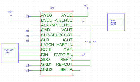

    Have you made any measurements with the DAC unloaded?
  • Yes, but the result is identical
    and sounds weird, if AVDD is 12V and I send 0x01ffff, Vout is 12V
                                       if AVDD is 5V and I send 0x01ffff, Vout is 5V
    I don`t know what problem is
    cf)REFOUT is 5V
  • Kang,
    Do you have any way of sharing the layout of this design?
    What is the output voltage at zero-scale for each of those cases? What about mid-scale?
    The only way the output voltage should be tracking with the supply voltage is if the output amplifiers are operating open loop and simply hitting their rails. If this is the case we should see the full-scale output regardless of what the input code is.

  • if I send 0x8888, Vout is 2.5V
    if I send 0x0000, Vout is 0V
    but if I send 0xffff, Vout is 7V
    1537.Schematic1.sch
    What is AVDD in this case? 7V? Previously you mentioned if AVDD is 5V then full-scale data output is 5V. Similarly if AVDD was 12V full-scale data output is 12V.

  • Kang,
    I see several independent ground connections in your schematic, are all of these grounds connected to one another eventually? All of the grounds need to be connected to one another or you have several floating potentials in this design that is going to cause either parametric degradation, complete lack of functionality, or conceivably permanent damage to the components.
    If you do not have a layout then the schematic you have shared is relatively meaningless. There could be any number of issues in the connections that you have made manually that is leading to a considerable gain error on the voltage output.
