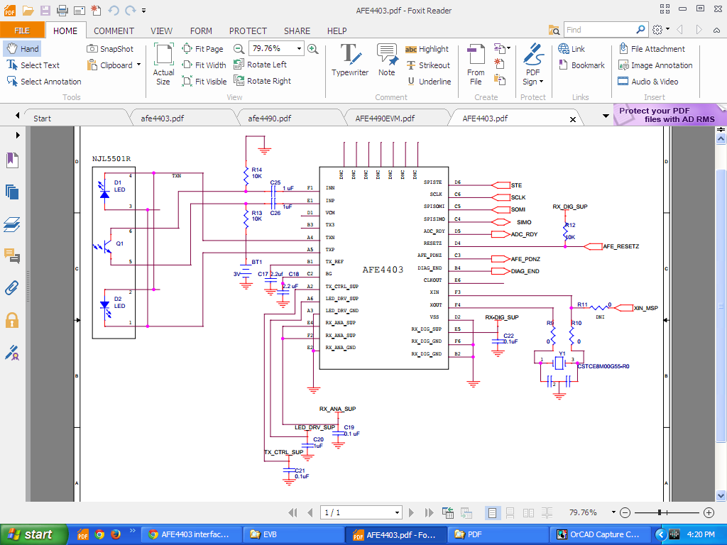

I am trying to implement a pulse oximeter using AFE4403 with MSP430FR5959. I have came across a forum post by Praveen Aroul , telling about interfacing AFE44X0 with NJL5501R. based on that forum pose i have came up with a schematic for AFE4403. My doubt is , will this implementation works fine.
The attached schematic is based on AFE44X0 forum post ( http://e2e.ti.com/support/applications/high_reliability/f/30/p/285068/995576.aspx#995576 ).
If the above is not working,then can i follow the same approach for AFE4490. Will that works fine.
I have seen ACLK of MSP430 is connected to XIN of AFE4490. does is needed anyway. because ACLK of MSP is an output signal and it is connected to an oscillator input of AFE4490. I feel like it is giving two lock signals same pins. am i missing anything in this point. The ACLK can be divided by 2,4.. factors, so we can provide clock to the AFE4490 from MSP430. If it is possible then what is the need of connecting an 8Mhz resonators ti that XIN. can anyone kindly clarify my doubts
