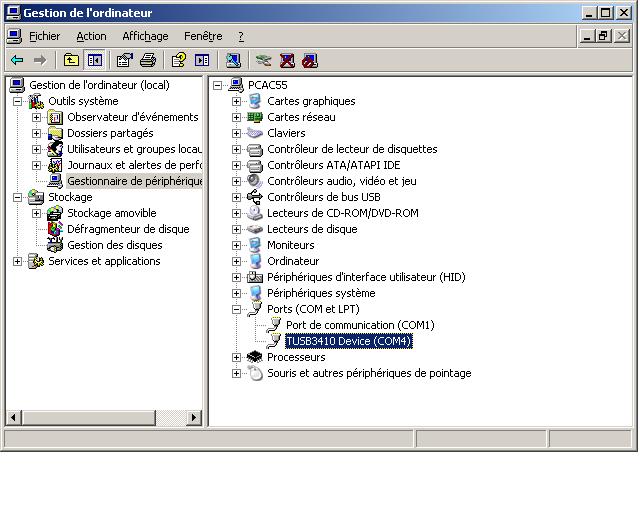

I have an issue with a ASD1248EVM-PDK installation. After following the installation guide, I stuck on the picture nr 12 (page 14). When setting the SW4 as said in the user guide and pressing OK, some times I've the improper BSL version message and sometime the programing failed message.
Is anybody has a solution ?
It's the first time I power up the ADS1248EVM-PDK, the driver is ok but what i find strange is the "BRD TEST" message on the LCD wich disappears each time I change the SW4 position to the BSL position.
The other thing is the green led at the left side of the LCD which is only lights on for 1s when I plug the USB cable and shut down after.
Is it normally ?

  • One possibility is that the hardware is trying to use a COM port higher than 20.  We have seen issues when Windows assigns the device to >COM20. We don’t fully understand the reason, but this seems to be an issue.  You can manually reassign the port to a lower free COM port (say less than COM10) in the Device Manager.
    Let me know if this works.
    If it doesn’t send me a screen shot of the C:\Program Files\Texas Instruments\TI3410XP\ directory with the file dates and sizes. There might be a problem with the loading of the TUSB3410 driver.

    Did you allow the new TUSB3410 drivers to install?  It doesn't look like the have been installed.
    In the Device Manager, the item "USB-Serial Port (COM2)" should show up as TUSB3410 Device (COM2).  These drivers should be included in the new installation exe and will start automatically when the plug-in is finished installing.  You should get a prompt saying "Where previous drivers installed.."  This is the beginning of the TUSB3410 drivers.
    Greg
    I update the T3410 driver by the new plugin but i still have the problem. The COM number is 4 since the beginning , I try another number (<10) but it doesn't solve the problem.
    With the old EVM plugin I had the "C:/program files/Texas Instrument/" folder (I had the same files with same size as AndrzejS) but with the new one I don't have it so I can't do a screenshot of it.
    Have you another solution ?
  • Hugo -
    So the files you are looking for were probably associated with the old driver, which are no longer present.
    Can you verify that the ADS1248EVM has the jumpers/switches configured in the settings shown in Figure 7 of the ADS1248EVM User Guide?  Different settings from this figure may not work with this software although the hardware will still work correctly.
    Additionally, when you restart the software and hardware, is the port recognized and just not programming or is the port not found?  When you get the error, can you capture/send the "fw_load.log" file that is located in the ADCPro installation directory under "saved"  (default will be C:\Program Files\ADCPro\saved\)?
