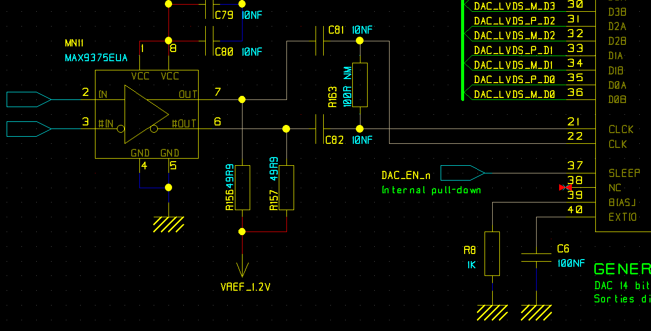

    I am designing a similar board with the DAC5675A and I'm having the same issue. I have a ALTERA CYCLONE 5 generating a LVDS clock and I want to use it for clocking the DAC5675A. Is the DAC5675A clock compliant with LVDS voltage swing, or should I use a voltage translator to convert LVDS into LVPECL ? I can see in the DAC5675A datasheet (p6) that the clock differential input voltage range is 0.4Vpp to 0.8Vpp. LVDS voltage swing is 0.4Vpp. Is it to close to the DAC5675A differential voltage range low limit ?
    Also, do I need to terminate the DAC5675A clock inputs (between the AC coupling capacitor and the clock inputs) ? I saw that the clock inputs are self-biased to 2V, but are there also self-terminated ? If no, how should I terminate it ? With a 100 ohms resitance between CLK and CLKP ?

  • Hi Maxime,
    DAC5675A has differential LVPECL compatible clock inputs. As you mentioned minimum clock differential input voltage is 0.4Vp-p. As long as your LVDS signal is able to meet the minimum clock input voltage requirements I think it should work.
    Yes, you do need to terminate the DAC5675A clock input with 100ohm resistance between CLK and CLKC. The 100 ohm resister should be placed before the AC coupling capacitors not after.

  • Hi Neeraj,
    Thank you for your answer.
    I will use a LVDS to LVPECL translator to be safe.
    You said : " The 100 ohm resister should be placed before the AC coupling capacitors not after ". By "before", you mean between the CLK pins and the AC coupling capacitors ? I inserted a part of my schematic above. Is this the clock circuit correct ?
    Maxime Puech.
  • HI Maxime,
    As long as the LVPECL driver see a 100 ohm termination, I think you circuit should work. Remove R156 and R157 and move R163 on the left side of C81 and C82( AC coupling caps).
