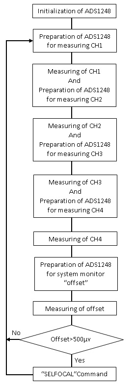

Also, I use a subroutine in the microcontroller to average the 4 last results for each channel. In every conversion, first I turn on the “BURNOUT CURRENT” then if I detect the sensor turn the burnout current off and measure the voltage on this channel again and if I doesn’t detect the sensor go to the next channel. Software algorithms are according to below flowchart.

When I use RTD sensor, everything is good and I have no problem and the result doesn’t have any fluctuation. But when I use TC, the amount of fluctuation is large, in a noisy environment the variation is about ±5⁰C.
Now I have some question:
What do you think about the fluctuation, is the input filter design incorrect?
Is it correct to turn on and off Burnout current in any conversion? Does anybody have better ideas?
How often I should use “SYNC” command?
Is it true to use system monitor for offset in every 4 conversion?
