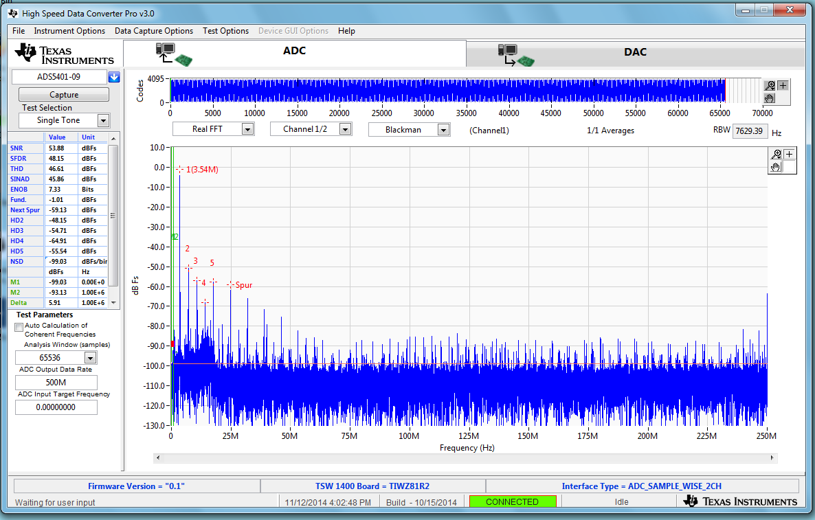

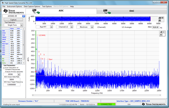

HSDC Pro Included Firmware + 15 MHz ChA Signal + 500 MHz ADC Clock signal
The configuration above functions properly and I can see the 15 MHz signal in HSDC Pro. However, in the following configuration I get nothing:

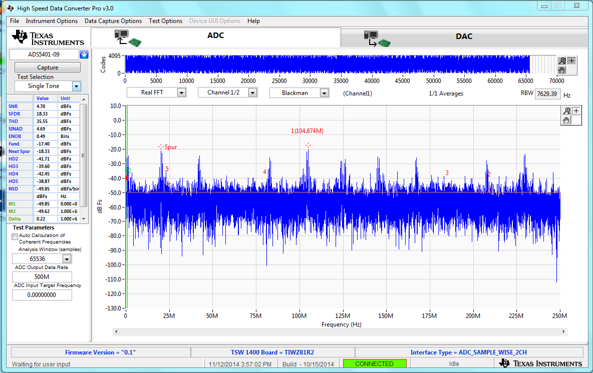

TI 'golden trigger' firmware loaded with HSDC Pro + 15 MHz ChA Signal + 500 MHz ADC Clock signal
I can send a capture command, and it is pulling something, but it appear to be just noise. There are a few things I made sure were set in the defines.vh file, but they did not fix my issue. First, I have:

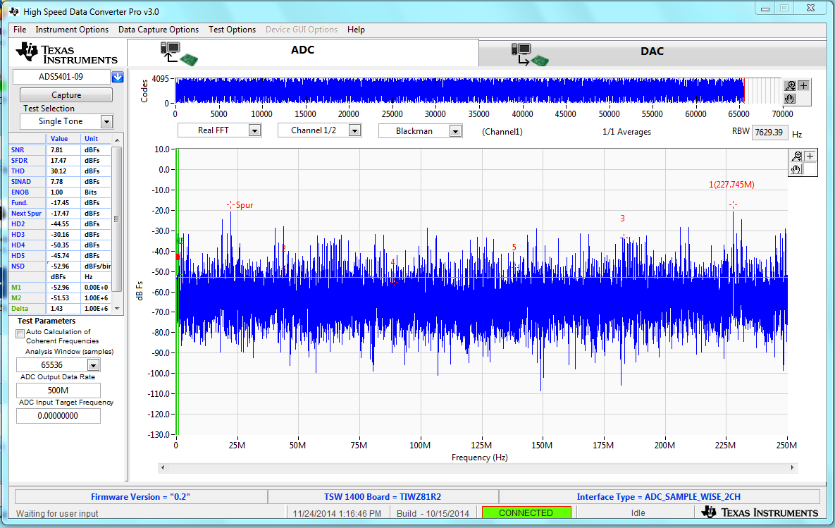

    From here, I then download the new firmware (ADS5404_5F00_working.qar) which I compiled and created an rbf out of (note- no changes were made to the project). Also note, I did not close and reopen HSDC Pro. Uploading this new firmware with no changes made to the clocks or the signal source gives me this:
    Note, this is similar to the other capture, in that I'm not seeing anything useful. If this was working for you, I wonder- does your setup require any additional clocks or special signals? Do I need to use the ADS5404 program to configure the ADC in a way other than default for the firmware to function?

    8. Select the new .ini from the drop down list, and select the new, unchanged firmware.
    Here, we still get complete noise, not capturing the 15 MHz signal. For reference, this is our .ini file:

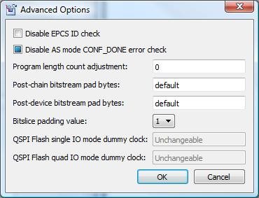

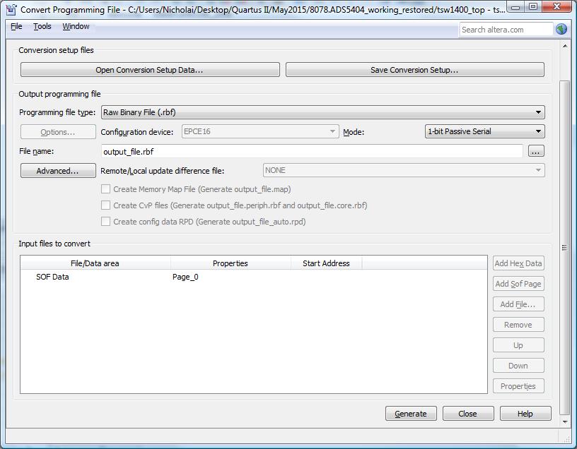

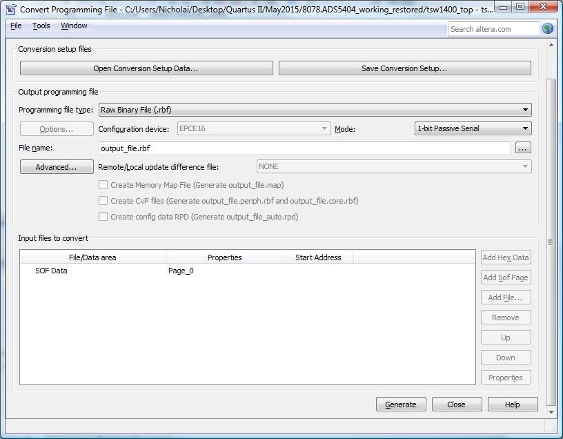

    And briefly talk about the creation of the .rbf. Currently, this is the process.
    1. Run Analysis & Synthesis -> Fitter (Place & Route) -> Assembler (Generate programming files)
    2. After running those three tasks, without changing any settings, I generate my SRAM Object File (.sof)
    3. Use File -> Convert Programming Files...
    4. Set the Programmer file type to 'Raw Binary File (.rbf)'
    5. Add a file to the 'SOF Data area', and select the newly generated .sof file.
    6. Clicking generate gives the .rbf to be used in HSDC Pro, after being renamed appropriately.

    There are no errors downloading the .rbf files. The problem arises when we capture data, it is complete garbage, but only when using the .rbf generated from Quartus. The stock .rbf works fine.

    For the working .rbf, the following LEDs are lit:
    • CB7
    • FPGA_CONF_DONE
    • USER_LED0
    • USER_LED1
    • USER_LED2
    • USER_LED3
    • USER_LED5
    • USER_LED6
    • USER_LED7
    This LED is off:
    • USER_LED4
    If I try the BAD rbf that I generated from the Quartus project all of the lights are the same. That is, the same as the working .rbf. The same LEDs are lit up, and USER_LED4 remains off.
  • Jim,
    Is there any further insight on this? If there is a difference in .rbf generation, any hints to what that might be? No special settings or aynthing to that extent? What version of Quartus is being used over there? Are there any other previous releases of the source code available, perhaps the one used in the release of HSDC Pro itself?
  • Nicholai,
    There is only one way to generate a rbf as far as I know. We are using Quartus 14.0, 64 bit. Have you tried entering a service request through the Altera website? The released firmware can be downloaded from the following link:
  • To attempt to rule out Altera (or show that it is the problem), I'm going to do fresh installs on two different machines to see if this is a synthesis problem. Is there any way you can pass along to me the results that your engineers had using the code you sent me?
    What kind of results are you looking for?  We've been using the TSW1400 to test our ADS540x EVMs for some time now.  For each device part number (ADS5401, ADS5402, ADS5404, etc) we build a batch of EVMs to be put in stock, and each EVM is tested before stocking and the FFT plot is saved for the serial number on that EVM.  Attached is one such FFT plot for an ADS5404 EVM.    This was taken using the firmware that was installed with the version of HSDCPro shown in the plot.
    Richard P.
  • I want to update this issue in case anyone has the same problems. I upgraded to Quartus II 14, and it appeared to have solved my problem for a few hours, before there were suddenly compilation issues. I spoke to Altera, and they were able to recreate the issue, but unsure of the cause. They suggested a reinstall again, or upgrade to 15. A re-installation of Quartus II 14 did not solve it, but Quartus II 15 did, and I have had no more issues since.
