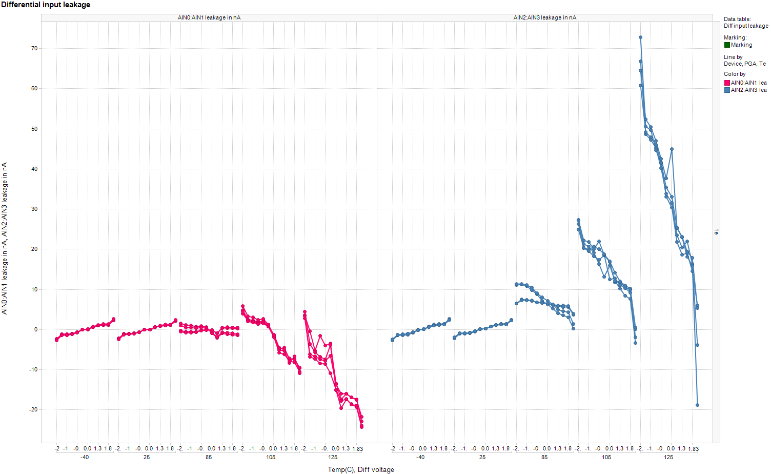

2. Seen in the Figure 16~19. Input current vs Input voltage,
   Could you tell me that why Input current of AIN2 and AIN3 are large?
   I seem that all input terminal are same on block diagram.
Kuramochi
  • Hi Kuramochi-san,
    The differential currents follow the graph given in the datasheet.  I've included the collected data graph below.  This is not a guaranteed specification so we really don't have minimum or maximum values as the current is not tested at final test.
    The bulk of this current comes from leakage.  Some of this is through the ESD cells.  For AIN3, in particular, the additional leakage is related to the low-side switch.  The current increases primarily at around 85 deg C or greater, otherwise it stays fairly uniform.

  • Hi Kuramochi-san,
    The graph I sent previously is the only data we have for differential current.  At 25 deg C the distribution is very close for the four devices tested.  On the graph it appears as only one device is plotted, but it is all four.  The difference from device to device is around 200pA across the devices at a particular voltage input.  I can average those numbers for those devices, but there is no guarantee that another set of devices will be the same as we do not measure this in final test as the currents are not a guaranteed specification.  Across the input range the differential current is about +/-2.5nA.

  • Hi Kuramochi-san,
    the plots that Bob posted above show the differential input current of four different devices over temperature.
    At 25°C you cannot see any difference between the four devices as the values are very similar (in the single digit nA range or less). At the higher temperatures you see some differences between the devices.
    This is all data we have.
    If you need to tell your customer a number, I would say a maximum differential input current of +/-10nA over the temperature range from 25°C to 40°C should be a realistic number. But we don't guarantee that in any form.
