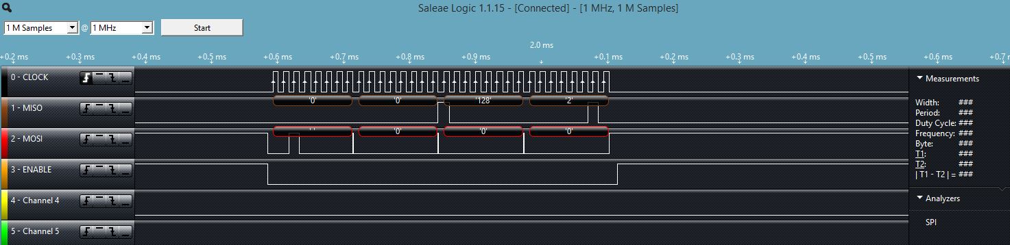

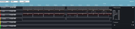

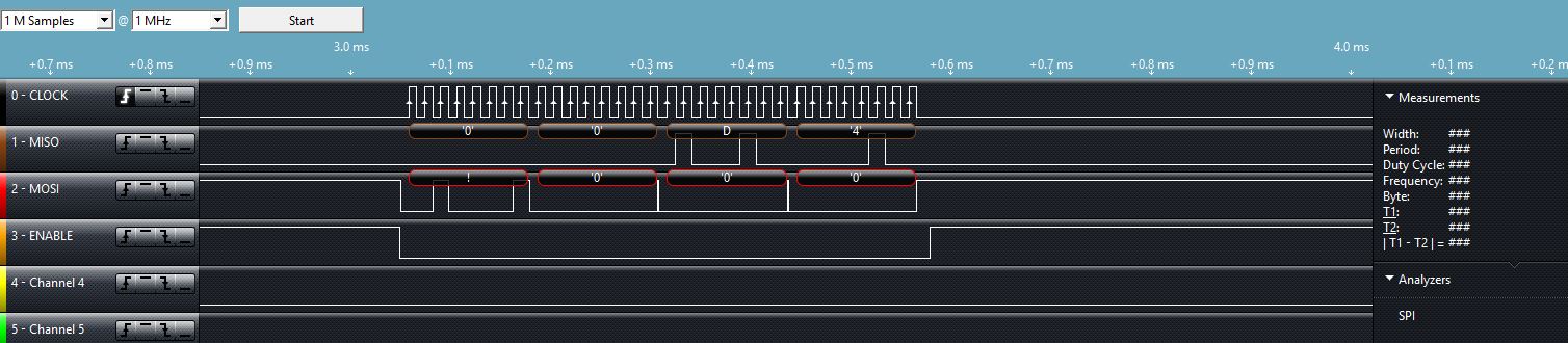

  • Hello Praveen,
    Thanks for your response.
    sizeof(uint32_t)=4
    Also, here are some screen caps of the output of my usb logic analyzer. I set the trigger on the rising edge of the clock.

  • Hi Praveen,
    Yes, it seems like I resolved it. For reading the registers properly, I had to send an additional dummy byte first in order to get the full 24 bits in return. I also ended up using the 'long' dataype instead.
    Thanks.
