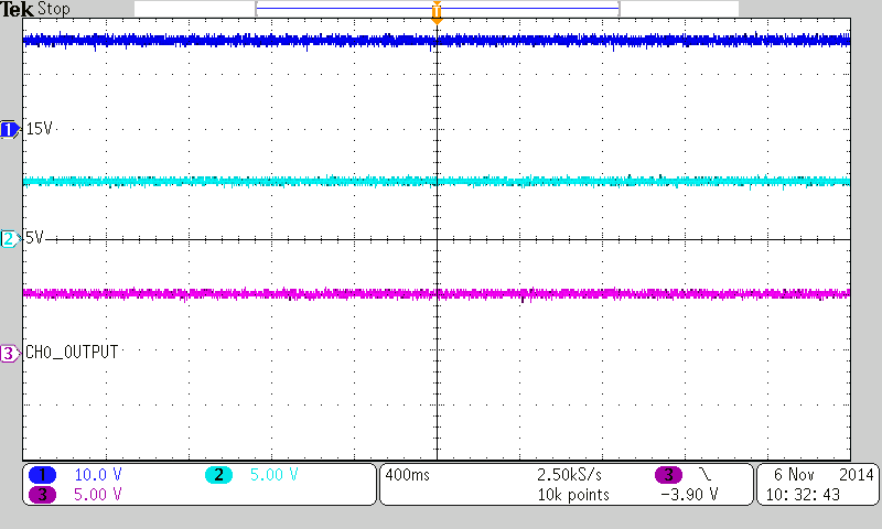

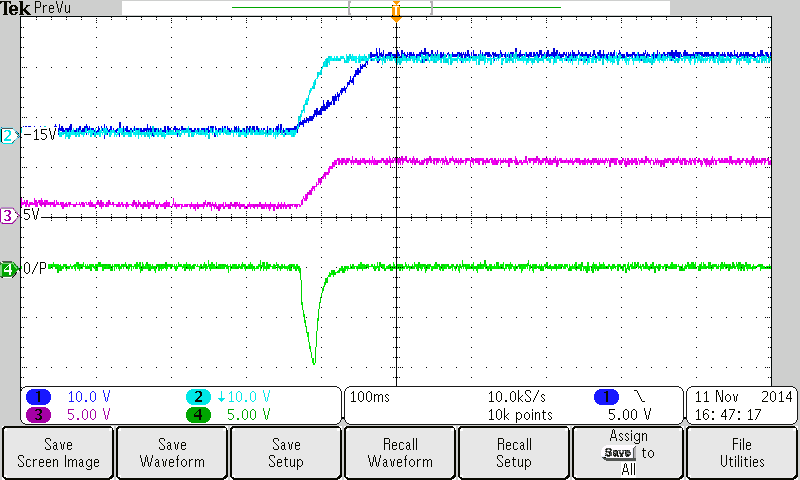

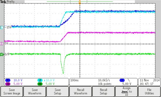

    Let me inform you, when glitch is observed -
    1. 5V and 15V both supplies simultaneously made ON
    2. Supplies made ON -> Analog Card generates output -> Both supplies are made Off -> again both supplies made ON
    Please refer the attached Glitch wave forms
    ( wave forms names are provided at extreme left of each wave form )
  • Hello Saurabh,
    It's difficult to 100% nail down the source of this transient since this can have dependencies on the environment in which the component is installed in addition to the component itself.
    For the DAC8760 family of device specifically, there is a recommended power supply sequence described in the datasheet. This supply sequence isn't required but it is recommended to help provide a smooth power ramp sequence for the part. Most ideal is DVDD, AVDD, then AVSS to reduce power up glitch. On a power down sequence the best sequence I can recommend is to keep DVDD high until AVDD/AVSS have dropped. This keeps the analog switches controlled by the digital core in a known state during power down rather than DVDD disappearing and unpredictable things happening inside the device.
    Voltage output stages in general, including the output signal chain of the DAC8760, have some parasitic capacitance to both supply rails. On a power-down event this capacitive coupling feeds through to the output and can create these output glitches. A method you can use to minimize the magnitude of this output glitch is to include a relatively large resistor on the output stage to allow for this output glitch energy to flow to ground. A 10kOhm resistor on the voltage output stage will have minimal impact on the voltage output accuracy and help minimize this output glitch considerably.

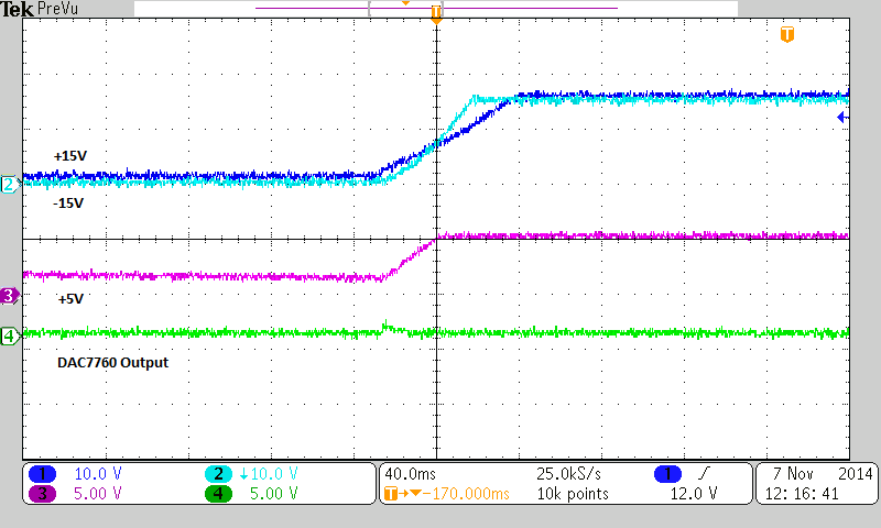

    At our end we have implemented one solution,
    We have added a RC Delay Circuit ( R=15E & C=10uF ) in Input Supply path of AVSS supply
    Please refer the wave forms below -
    a) Output without RC
    b) Output with RC
    Please share your comments on the same
  • Saurabh,
    Yes - my proposed solution to reduce the glitch on the voltage output (short of the recommended power supply sequence) was to include a 10kOhm pull-down resistor on the output pin. For applications that share the voltage and current outputs on a single output terminal this is most likely not an option because the pull-down resistor to ground will create a current divider with the load and adversely affect the accuracy of the current output.
