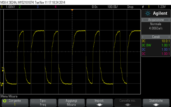

The Manchester sub-carrier frequency of the ADS1203IPWT is 10 MHz and the clock of the AMC1210 is 32 MHz

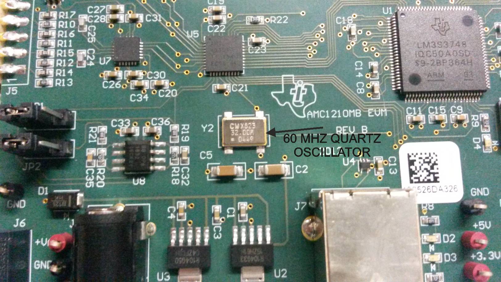

    The processor on the AMC1210MB-EVM is not able to accomodate the Manchester Decoding Mode of the ADS1203.  The clocking scheme mentioned in the datasheet is not possible to implement with the Stellaris process found on the board.  I'll see if we can get the AMC1210MB-EVM Users Guide updated to reflect the fact that the Manchester mode is not supported.

    You are correct in that the AMC1210 can process the the Manchester stream and decode it's clock/data directly, but the AMC1210MB-EVM can't provide a 60MHz clock to the 'CLK' pin of the AMC1210.  The data stream from the ADS1203 is coming out of the part at 10MHz, so the AMC1210 needs a (min) 60MHz system clock to be able to perform the decoding.  Getting the proper system clock from your TMS320C674x device should not be an issue though.

    As stated on page 17 of SBAS372D is right that the ratio between AMC1210 and Manchester frequency must be more than 6 times. 0412.IQD-CFPS73.pdf
    Do not worry about the old AMC1210 mother-board: we have in stock some SMD 64 MHz oscillators in sizes and characteristics equivalent to the 32 MHz installed on MB.
    If there are no problems between AMC1210 at 64 MHz and Stellaris, we can easy replace the Y2 oscillator with the 64 MHz model.

    The 64MHz won't be an issue for the AMC1210 (it can run up to 90MHz) and the colck is not used by the processor at all, so changing it out is not a problem.

    Today I was able to change the oscillator mounting the 64 MHz model.
    In this way the Manchester demodulator works correctly.
