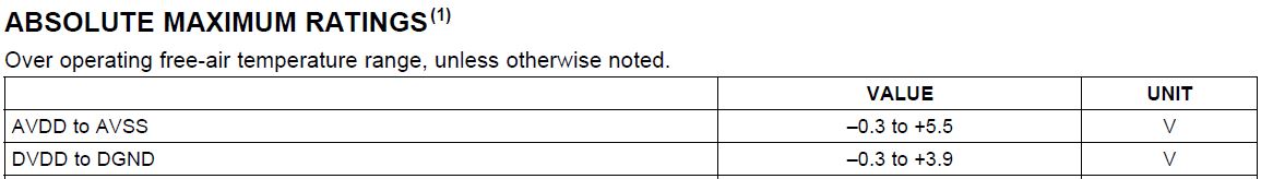

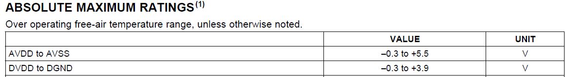

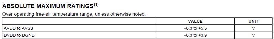

  • Hi Arthur,
    Before we go any further, can you please confirm what voltages you are using for the analog and digital supplies? I'm sorry I overlooked this initially, but the supplies listed in your first post are not a valid configuration for the ADS1299.
    The Maximum Ratings can be found on page 2 of the datasheet:
  • Hi Ryan,
    We are using 5V supply for analog voltage and 3.3V for digital voltage
    Arthur

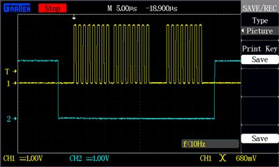

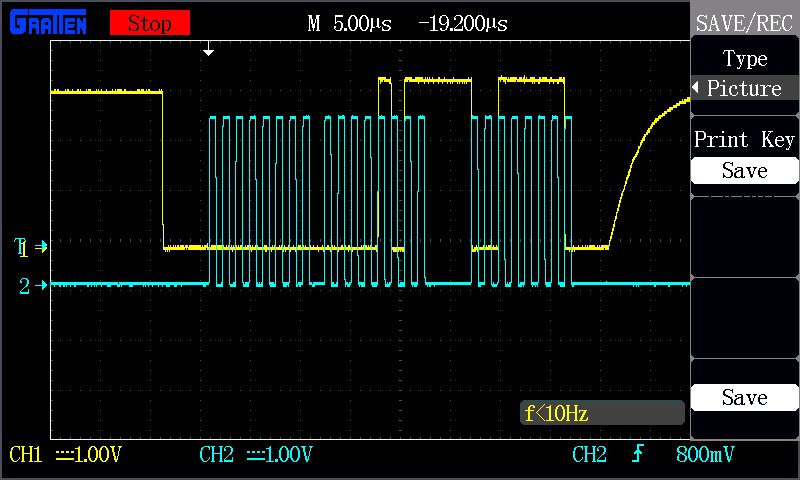

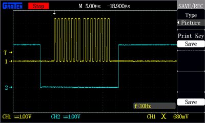

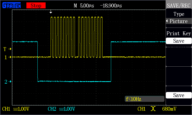

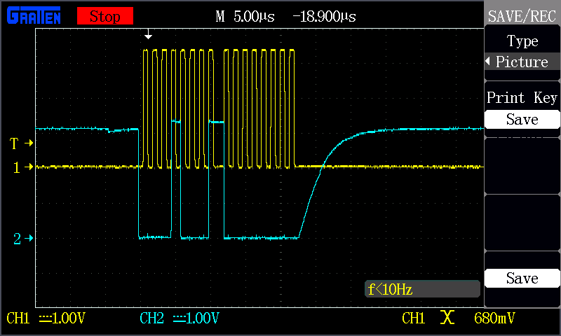

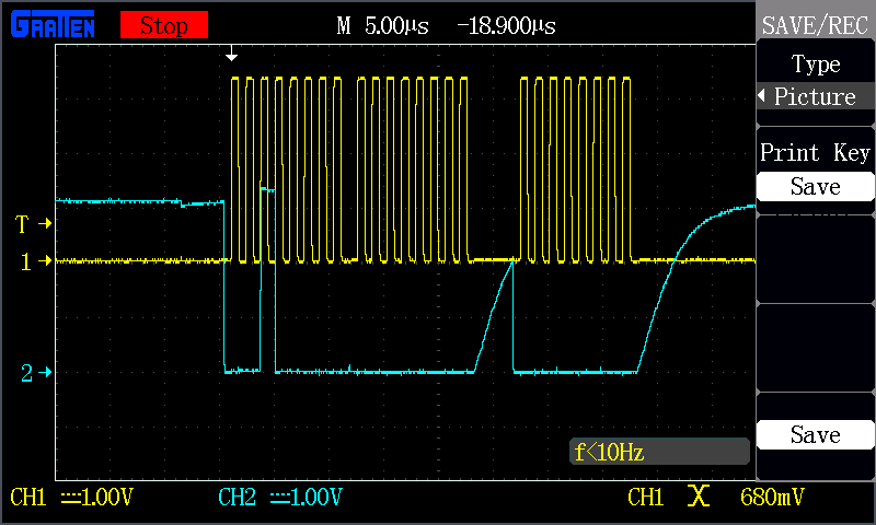

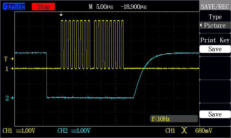

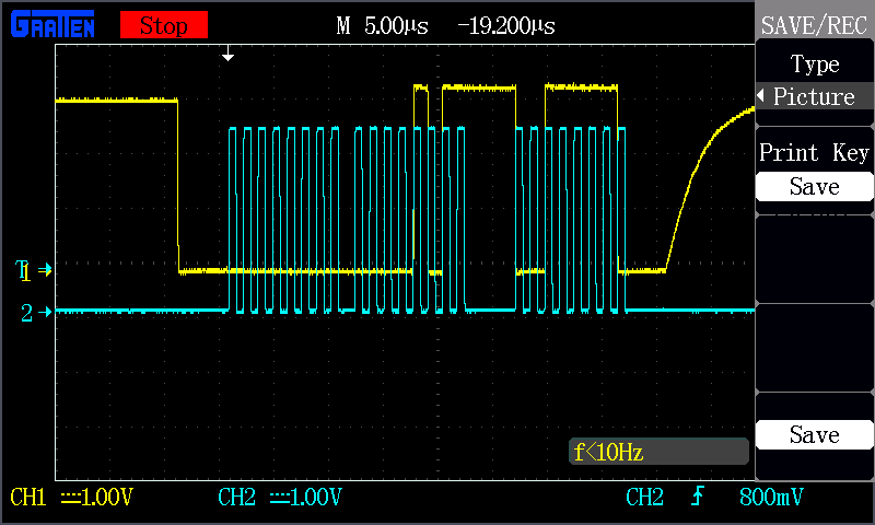

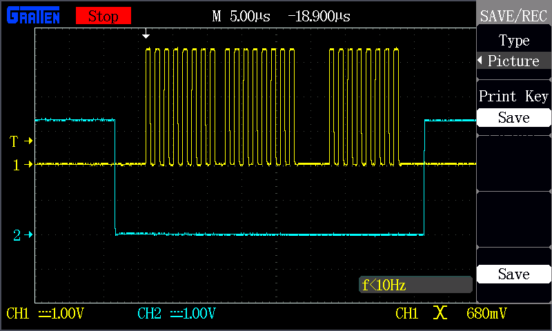

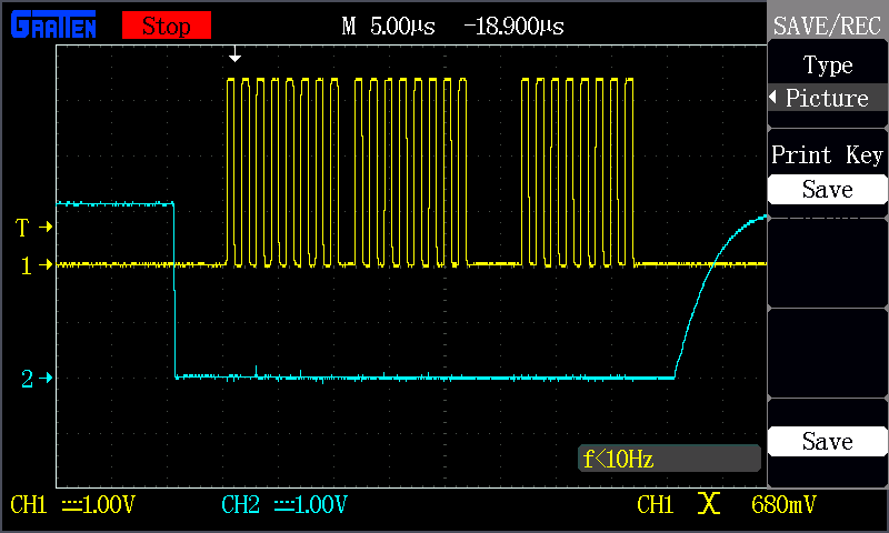

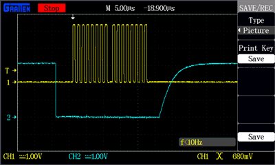

  • I have take also some picture of the spi signal thanks to an oscilloscope (only two channels). I record a picture with SCLK + each signals (SCLK + CS, SCLK + MOSI, SCLK + MISO for SDATAC and my RREG commands
    You can see that bits send for SDATAC(0x11 0x00) and RREG (0x20)  for device id are correct. CS is low during the commands. I see nothing on MISO, just a modification of voltage. Is it helpful for you ?
    CS + SCLK for SDATAC
    CS + SCLK for RREG
    MOSI + SCLK for SDATAC
    MOSI + SCLK for RREG
    MISO + SCLK for SDATAC
    MISO + SCLK for RREG

  • Hi Arthur,
    Thank you for sharing the scope images, it is much easier to see what is going on. :)
    SDATAC is only a 1-byte command (0x11). I am not sure if the device will be "confused" by the second byte (0x00), but it is not necessary to send it.
    RREG also looks correct (0x20 0x00). I am curious as to why MOSI is trying to rise after the first 16 SCLKS. Still, I would expect MISO to toggle with the correct ID register value.
    Please let me discuss this further with our team. I will try to reply by the end of tomorrow.
  • Ok Ryan. So... You can say that I am very stupid... This morning I run the setup again and I double check again everything.
    When you told me to check the voltage I only check the value in Datasheet and the wiring setup to be sure to connect the good pin between the two boards. This morning I also check voltage with oscilloscope.
    I discover that the VDD_5V of the BeagleboneBlack deliver 0V to the pin on the oscilloscope... In fact after some check on the datasheet I read that the VDD_5V is only supply when the 5V barrel jack is used.. I was currently supply the board by using the USB....
    So now I plug the jack supply and I am finally able to see the good value on the oscilloscope on the MISO :
    I am always getting the same bad  value in my code but at least I can see the good one on the oscillo. Just need to find the issue in my code now.
    The 16 first SCLK are for RREG commands. On the last 8 SCLK I can see 0011 1110. By reading the datasheet I can see that I must read XXX 1 1110 (X for bits unused). So I guess that it is good now. I just need to fix my code.
    The answer from the ADS1299 is correct here, right ?
    Next step will be to test my code to configure all the register and to get the EEG signals.
    Thanks again Ryan !

  • Hi Ryan.
    Ok Ryan so I get it. I am finally able to read my device id !
    My last error was in the device tree file on my spi on the Beaglebone Black.
    I reverse the input/output mode on the SLCK again.
    My device tree file configuration :
    before :
    0x150 0x10 /* spi0_sclk, OUTPUT_PULLUP | MODE0 */
    -> Not able to read value on MISO
    now :
    0x150 0x30 /* spi0_sclk, INPUT_PULLUP | MODE0 */
    -> it's work !
