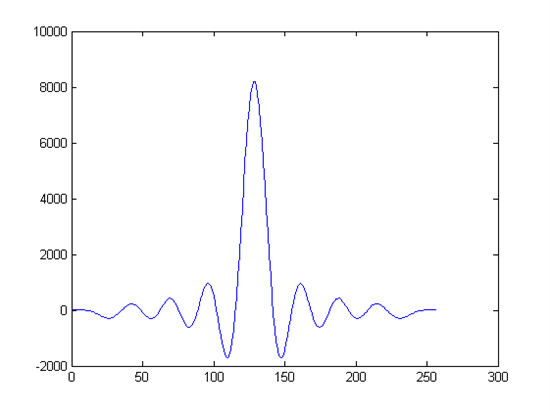

However I got some confusing results by using test vectors provided in EVM package.
1.decimation factor=4, below is the original filter plot,

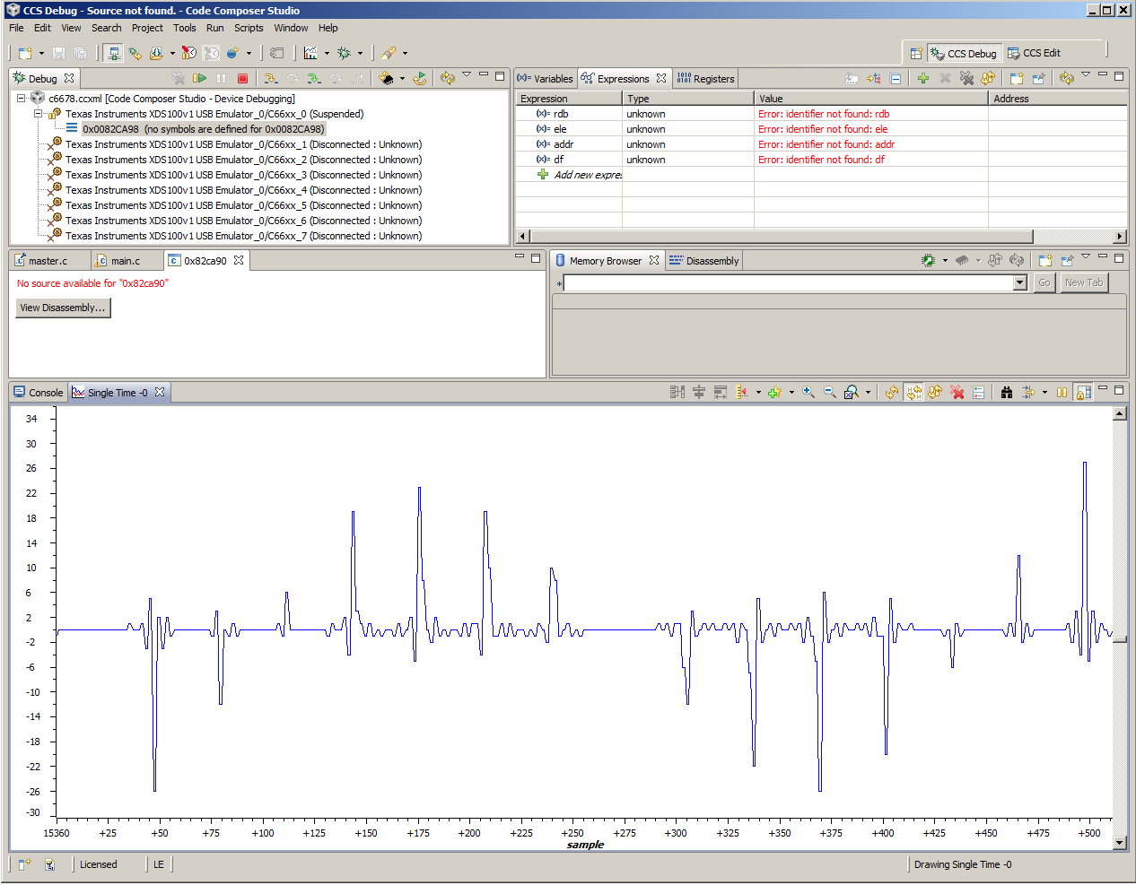

below is output of coefficient test mode which has been decimated by 4,
Question: how does the negative impulse response come from?

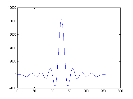

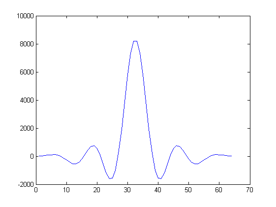

2.M=16 original filter

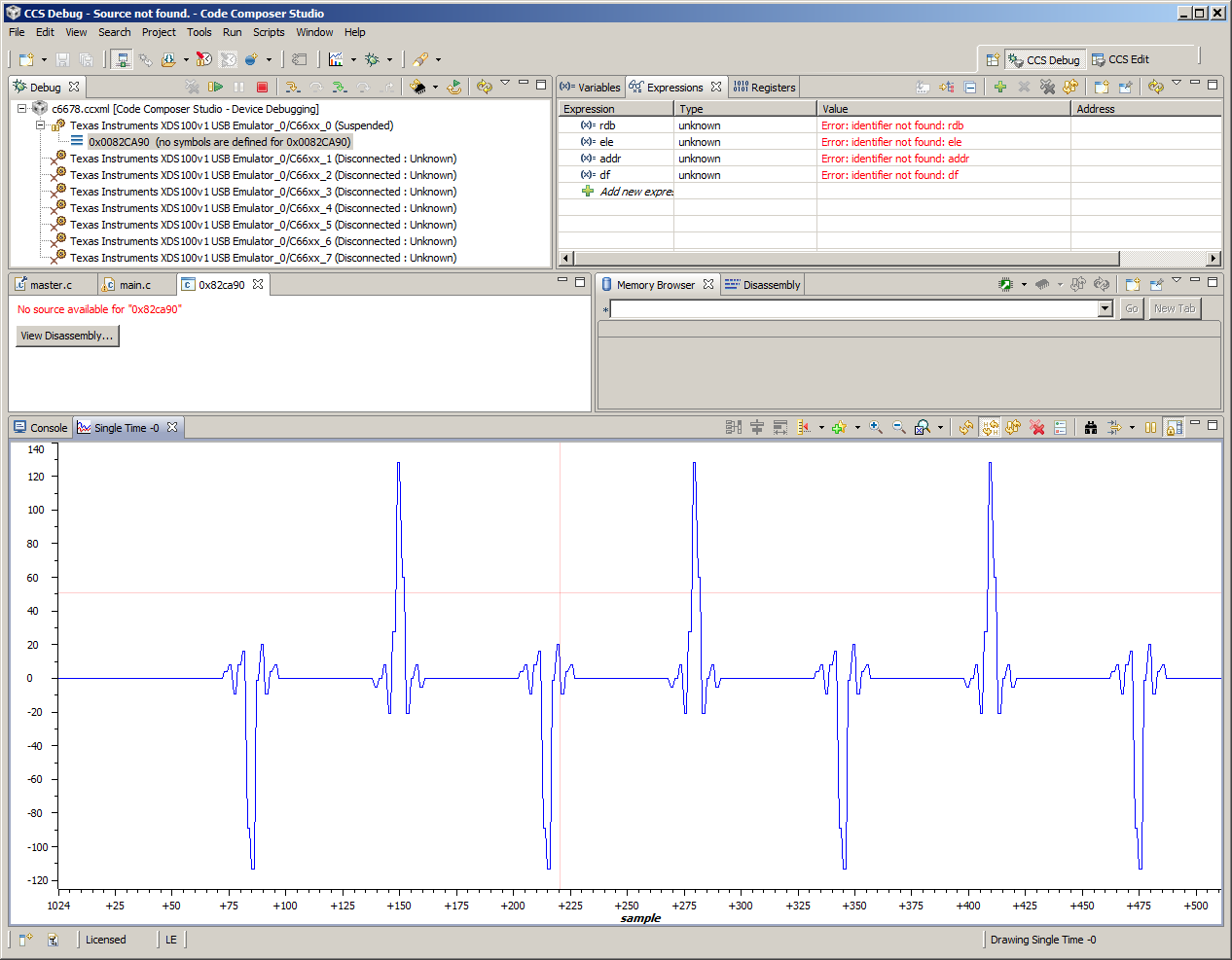

test result of coefficient test mode output which has been decimated by 16,
Additional question: how to explain the distance between response? In M=4, the distance is 64, however in M=16 the distance is 32.
And maybe the root question is: what's the real input sequence in coefficient test mode?
