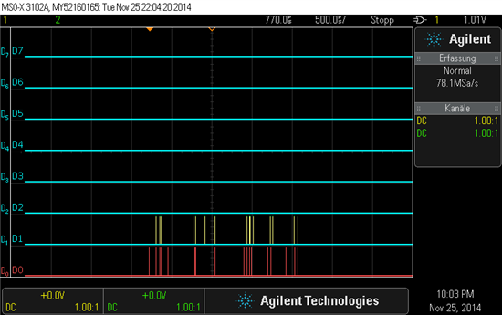

I'm trying to switch the voltage output of the DAC8760 to 0V and back to the previously set voltage by pulsing the CLR and LATCH pins as described in the data sheet on pages 11 (timing) and 36 (DAC CLEAR). The idea is to have a precision voltage source with asynchrounously switchable output.
Setting up the DAC output and clearing the output voltage with the CLR pin works fine, but I cannot restore the pre-clear value by "pulsing the LATCH signal". The output stays at 0V. I keep the SCLK pin low - so nothing gets clocked in. As it is I can only restore previous output via MCU by writing to the DAC register again. But this is way too slow to be of any use.
I use a FPGA to translate a digital input signal (hi = output 0V, lo = output voltage) to signals on CLR and LATCH.

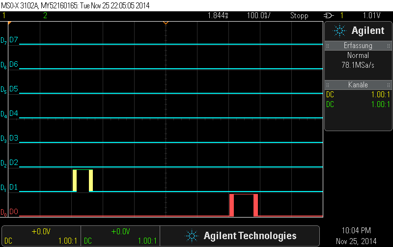

To switch the output to 0V I issue a 50ns pulse (hi) on CLR
To restore previous output I pulse LATCH for 83ns (hi).
I connected the digital switch input to a pull up and to GND with a wire. If I put the wire in (output should switch on) I get this on LATCH and CLR pins (the port bounces):
D0 = LATCH; D1 = CLR; D2 = SCLK

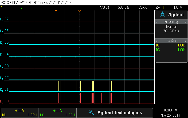

Zoom on last pair of pulses:
The FSM in the FPGA makes sure (and I checked this) that there is always a CLR pulse between 2 LATCH pulses or a LATCH pulse between 2 CLR pulses. As you can see the last pulse is on LATCH.
As I understood the datasheet this should restore output. Sooo... What did I miss? Why doesn't it work? Any hints and ideas are much appreciated.

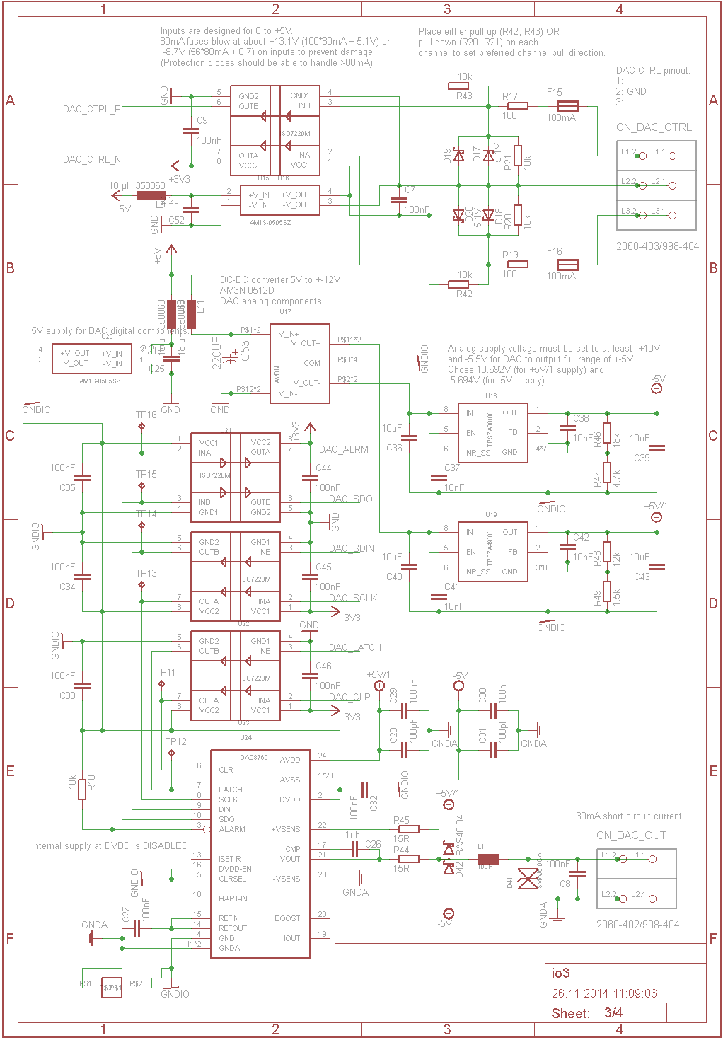

    Are you conducting your tests on the EVM board or on a board that you have designed yourself? If it's a board of your own design, can you please share the schematic and layout? In either case, where are the probes placed for you to generate the captures you have shared in this thread?
  • Kevin,
    thanks for verifying the concept. I don't have the EMV board available, unfortunately. I tried single pulses on CLR and LATCH by using the MCU today, but still no luck.
    The schematics for the DAC part are derived from the application circuit in the datasheet.
    DAC schematic and layout:
    The MCU/FPGA side of the ISOs are directly connected to a MCU (ALARM, SDI, SDO and SCK) or FPGA (CLR, LATCH and CTRLP, CTRLN) on other boards with 3.3V. Nothing special there and the longest traces are on this board.
    A LATCH-signal from the MCU can optionally be forwarded by the FPGA. Otherwise LATCH is fully controlled by the FPGA (as is CLR) depending on the state of the CTRLP and CTRLN signals (control input intended to switch the DAC output).

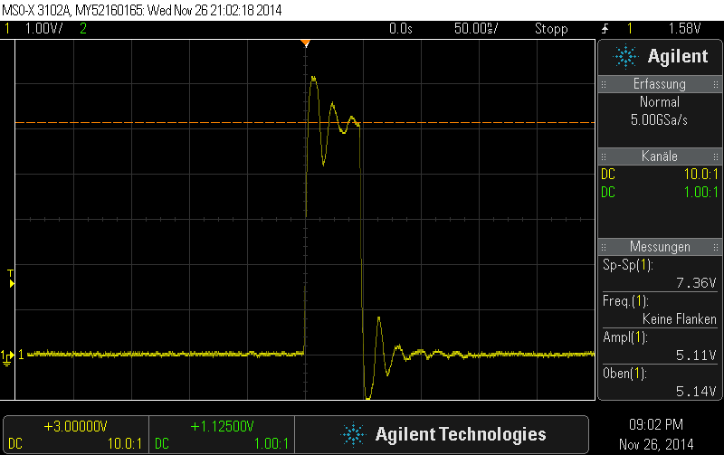

    The probes are placed on the FPGA/MCU side of the ISOs. I'll try to measure the other side later (too bad I missed the opportunity to place some test points on the 1st layout).
  • I now measured CLR and LATCH directly on the DAC and I can confirm: The signals seem to be forwarded correctly.
    A CLR pulse created by the FPGA looks like this:
