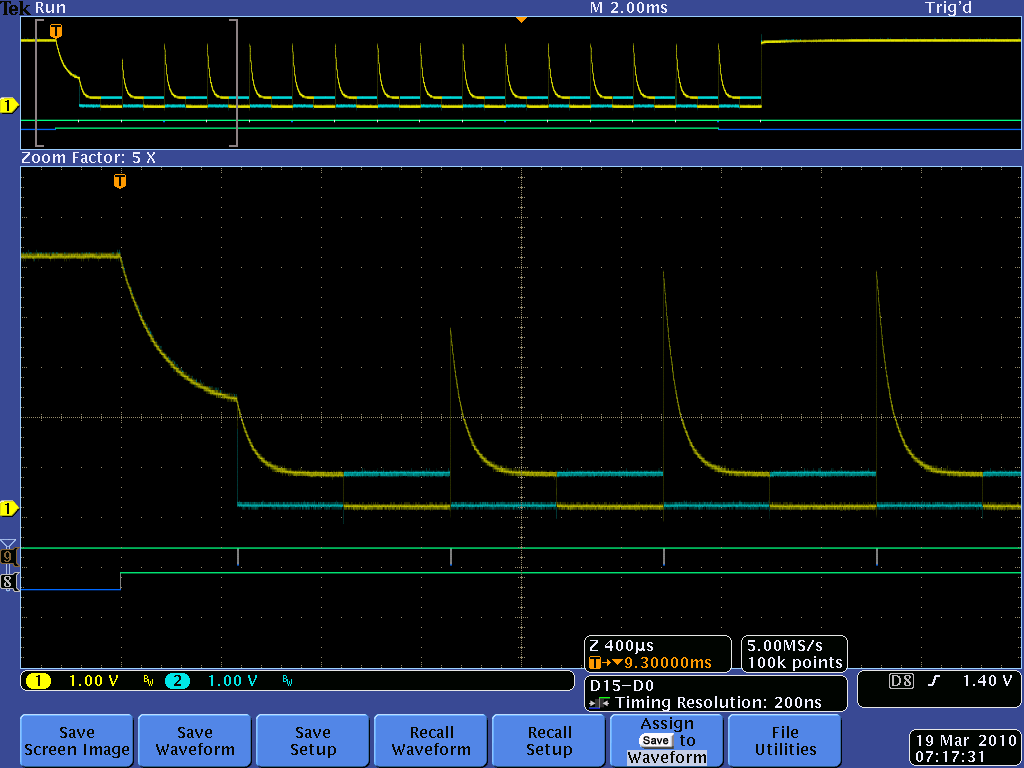

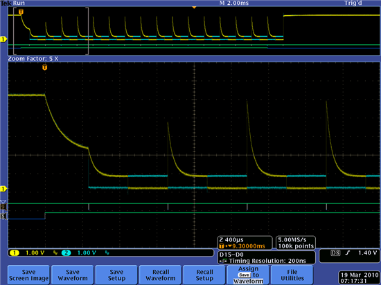

Attached is a scope picture showing what's happening. The bottom-most line, marked "8", is START. Above it, marked "9", is the DATA_READY signal. Yellow and blue are the positive and negative signals to be converted. This image is after the "fix", so the channel not being chopped is DIFF0. The subsequent channels are AIN0 - AIN15.

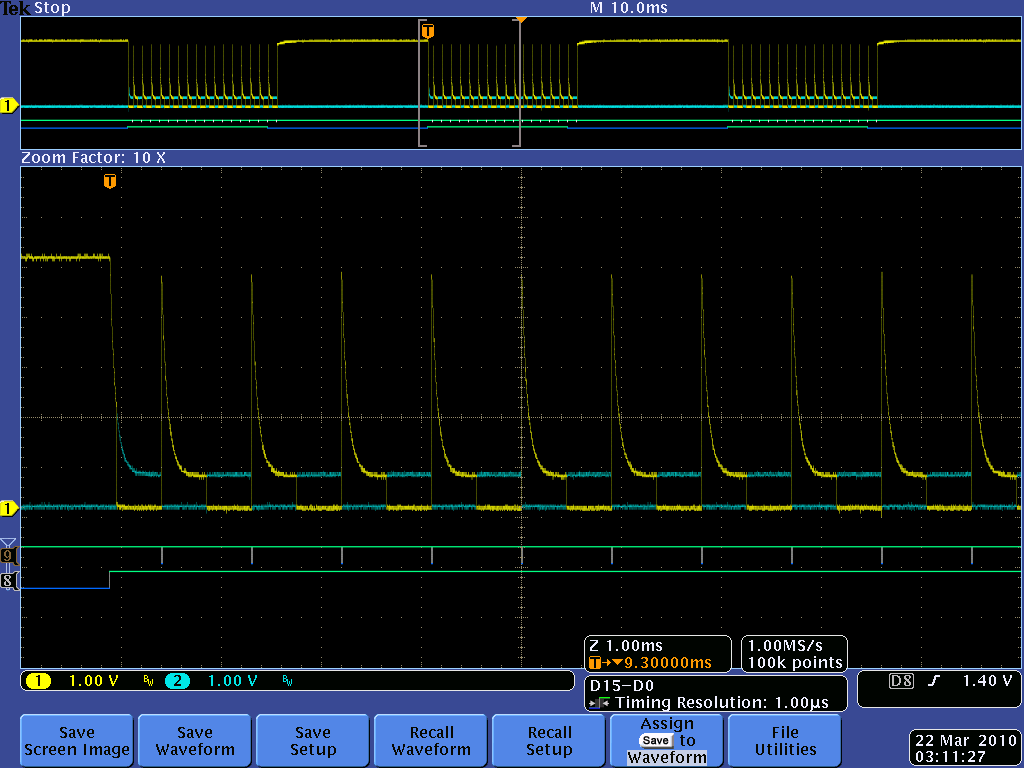

    Attached. Good point, in that trace, you really can't see that the chopping doesn't occur, since with the "fix", the two signals measured first are almost the same, and you can't see that they aren't being swapped. My bad. It's clearer in this shot.

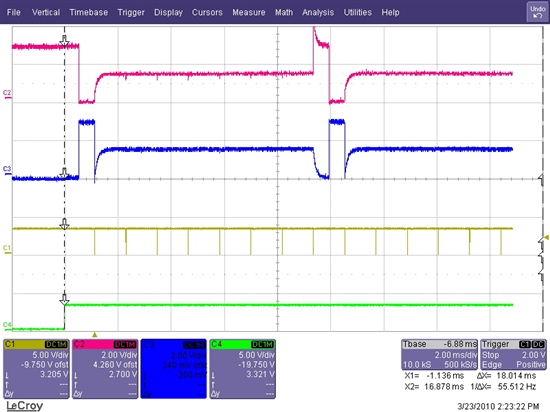

    I powered up the ADS1258 here and saw the behavior when I tried to copy your procedure. See below:
    Red - MUXoutP
    Blue - MUXoutN
    Yellow - /DRDY
    Green - START
    In the scope picture I have a 3V input connected to AIN0 and nothing connected to the other analog inputs. I then Select to have the ADC in autoscan mode and select channels Ain0 - Ain7. When I bring START high I see that I do not have an issue with the first sample chopping.
    Note that I am not writing anything to any of the registers during my acquisitions. Are you writing anything to the part during your first acquisition? Utilizing the WREG command?

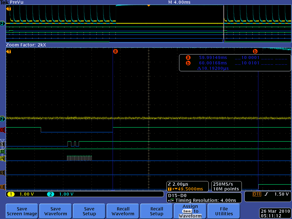

    I understand that you have a work around, but we would like to look into this some more from our end. Is there any way you can get a scope picture without the fix showing the DIN, START, /DRDY and SCLK signals. I want to see your timing relationship between when you write to the MUXSG0 register to when START is brought high.

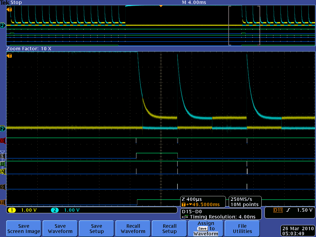

    Signals:
    Analog, yellow/blue = signal.
    Digitals (the markers are in the left column):
    'Red 10' is SPI slave-select.
    'Black 8' is SPI MOSI
    'Green 13' is DRDY.
    'Yellow 12' is SPI SCLK.
    'Brown 9' is SPI MISO.
    'Orange 11' is START.
    First picture shows the first few conversions of the cycle. Second picture zooms in to show the SPI details, and on that shot, I have used the A/B markers to measure from SPI slave-select deassert to START assert time - a bit over 10 microseconds.
