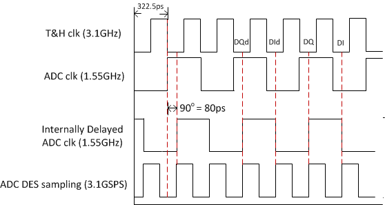

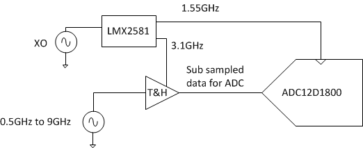

As per my application I have an 12 bit ADC(ADC12D1800) for the RF signal digitalization in the range of 0.5GHz to 9GHz , In order to down convert  this in the front end of ADC I have track & hold amplifier. Both T/HA & ADC requires the sampling clock , I planned to provide 3.1GHz sampling clock to THA & 1.55GHz sampling clock to ADC(ADC will be operated in the DES mode). As per the above configuration I want 90 shift between 3.1GHz sampling clock & 1.55GHz clock.I planned to use LMX2581 as a clocking source for ADC as well as TH/A which has two o/p channels. As per my application requirement I want 90degree phase shift between 3.1GHz clock as well as 1.55GHz clock for this I planned to use delay block which is available inside the ADC. I have one query on this ADC12D1800 what is the maximum possible delay we can introduce on the sampling  clock on DES mode of operation. Whether the above circuit will work ?

    If I understand correctly, it sounds like you are trying to use the following configuration:
    You could use the coarse delay inside the ADC to shift by 90 degrees (~80ps) for falling center aligned data or 270 degrees (~240ps) for rising center aligned, both of which are within the range of the ADC. A 90 degree phase shift is shown below.
    Using both the coarse and fine delays of the ADC12D1800, this configuration would work. The only caution I would advise is the aperture delay adjust is limited to input clock frequencies <1600MHz. So for this application of 1.55GHz it is ok, but if you tried to exceed the 1600MHz limit you would run into problems.

  • HI Luke,
    Thanks for the reply, Yes The above images are correct both are matching as per my requirement. But I need some clarifications on the above waveform:
    I want ADC clock to be lagged by 90degree  from the TH/A clock, the above waveform shows that ADC clock leads the TH/A(hmc661lc4b) clock by 90 degree. As per my application I wants to sample the TH/A o/p at the following edge of TH/A clock & both the edges of ADC clock using DES mode of operation.

  • Hello Rajesh,
    Sorry for confusing you. The aperture delay does cause the ADC sampling clock to lag the T&H clock, not lead. The timing diagram would look like the following where delaying by 90 degrees (~80ps) will result in falling center aligned data.
