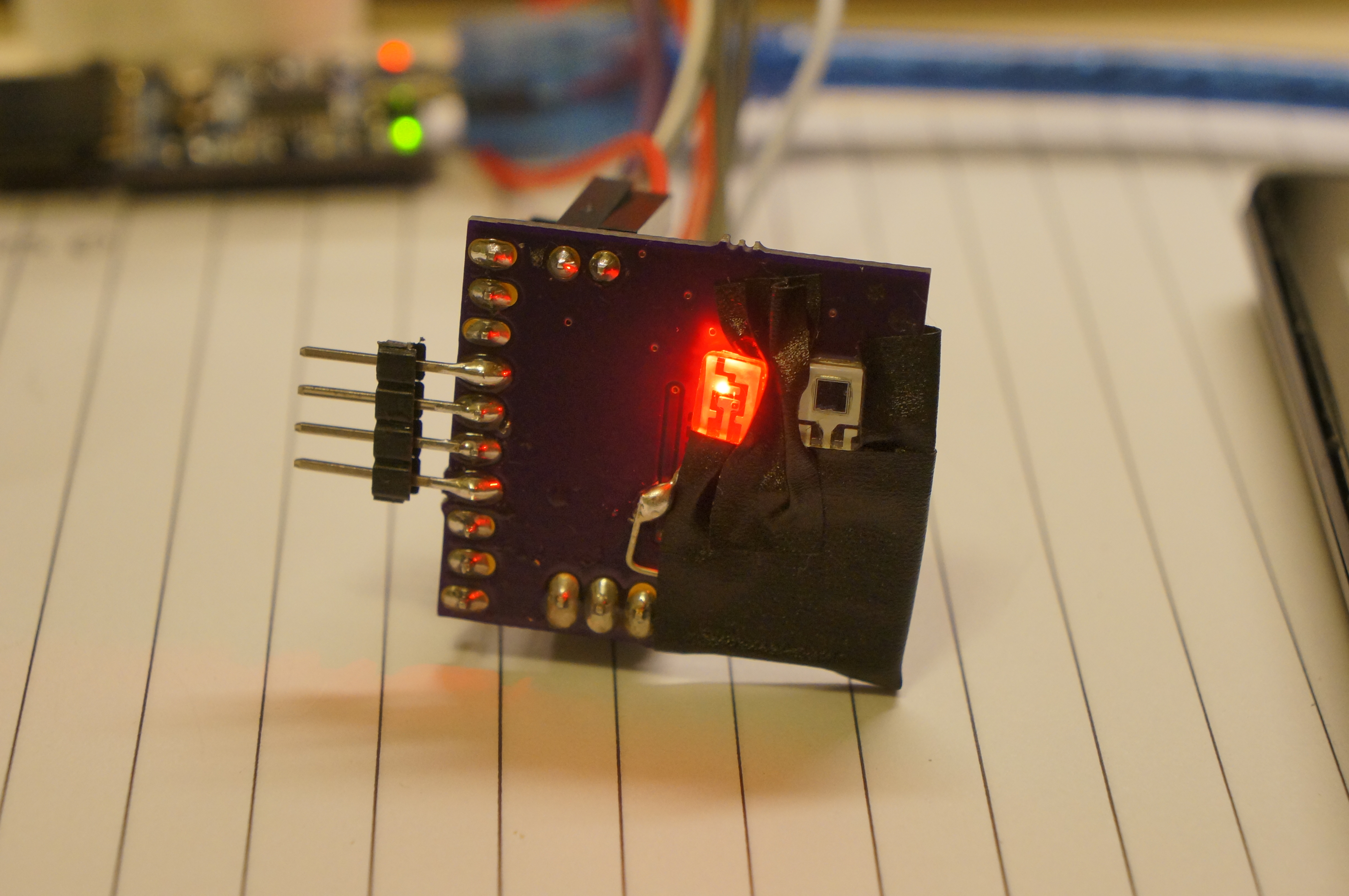

Hi all,
I've build a AFE4400 breakout board, and I'm sure AFE4400 is working fine (Bandgap voltage,4 Mhz CKOUT,DIAG=0....)
the sensor is DLED-660/905-CSL-2 plus PIN-4.0-CSL
and I can get the correct reading from AFE4400 before I put my finger on, the reading does change with the distance
but when I put my finger on the sensor, I can't see the up and down by the heartbeat.

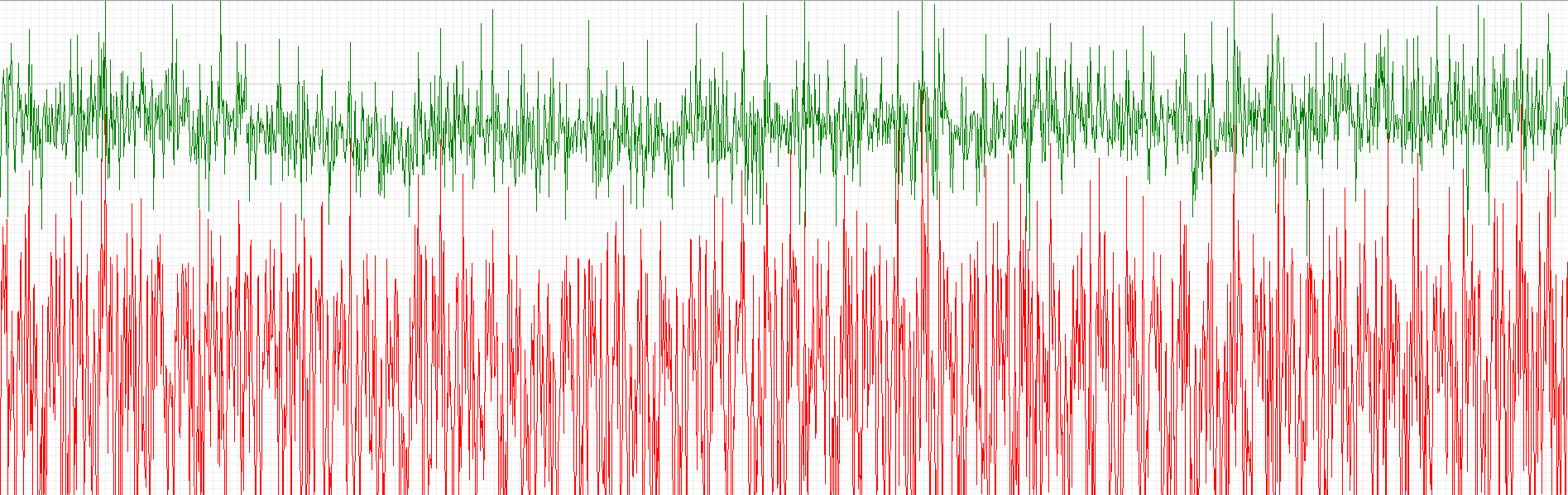

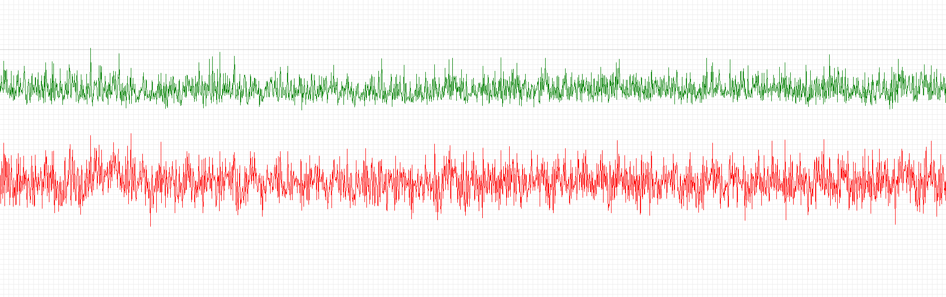

  • hi Praveen,
    Thanks for the reply,here is the PPG waveform
    the green one is LED1 red one is LED1 - ALED1 quite flat .... I can't see any thing from this PPG waveform ,
    also the voltage is pretty low, LED1 is only -0.009v,
    after writing  0x4406 to TIA_AMB_GAIN (which is 12db gain plus Rf = 1M)
    Whang wen-fu.

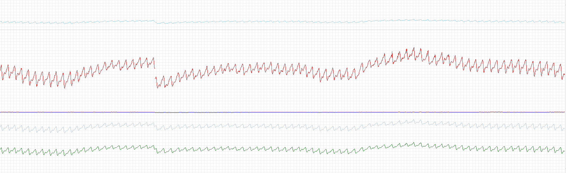

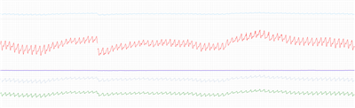

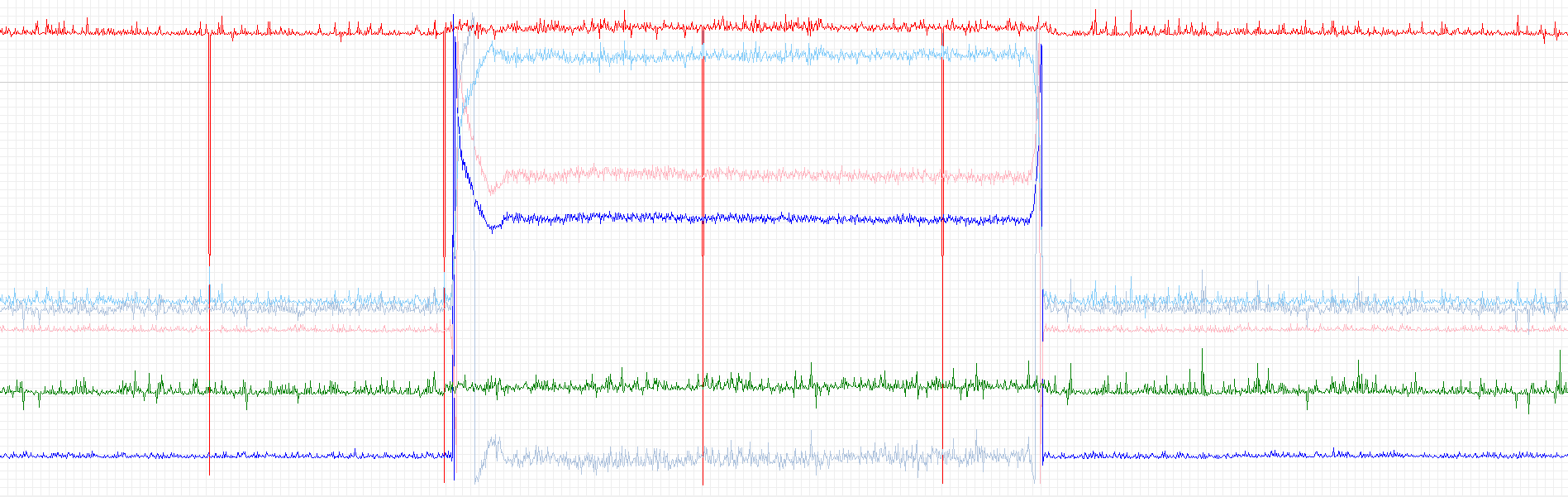

  • I figure out where might be the problem
    After plotting six different var, in the middle of the graph ,i put my finger on the sensor
    red //LED2
    blue //ALED2
    green //LED1
    lightpink //ALED1
    lightskyblue //LED2-ALED2
    lightsteelblue //LED1-ALED1
    It seems that LED1 and LED2 never change!!
    but because the change of ambient light, the LED1-ALED1 still change.
    What happened to LED1 and LED2 ?

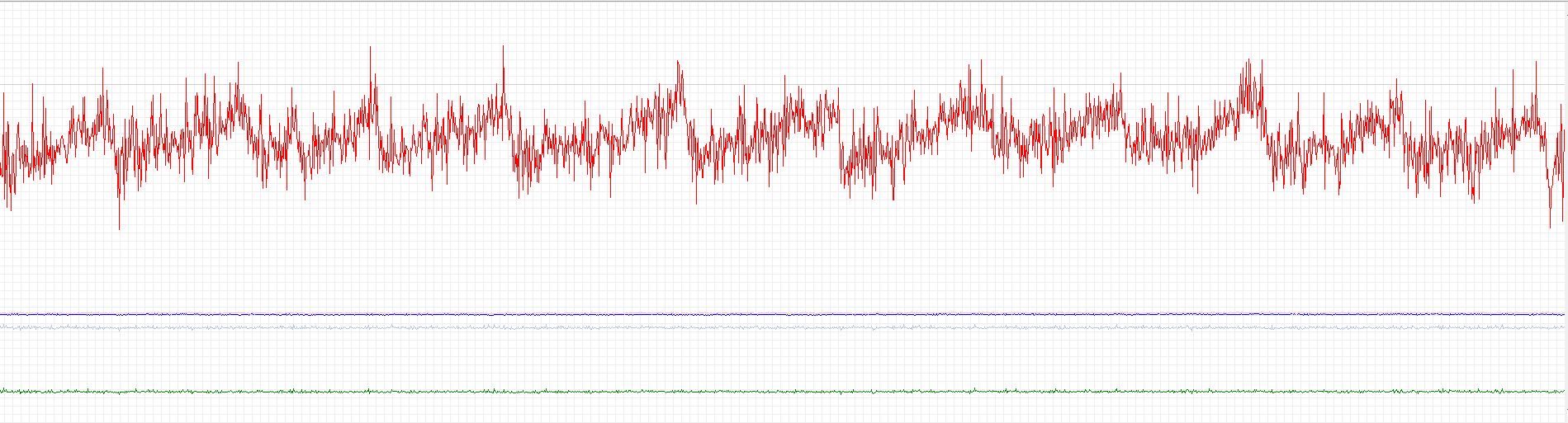

  • Hi Whang,
    It looks like the LED1 and LED2 signal is saturated at the TIA output. This is because any change in the ambient light affects all the channels equally. But in your case, you do not see any change in the LED1 and LED2 channels.
    You may have to reduce the TIA gain to avoid saturating the signal.
    Could you check reducing the TIA gain?
    Also it would help to analyze better if you could provide waveforms that have the X and Y axis labels marked.
    Praveen.
  • Hi Praveen,
    Thanks for the answer, the data seems to be good now
    after ave for 10 data point:
    and sorry that it still no labels, because the program I use doesn't have the option,
    I need to write my own plotting program to do that.
