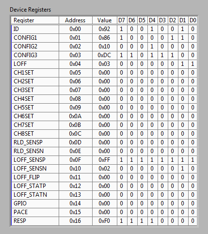

Prior to starting work, I've tested my simulator with the ADS1298ECG-FE Product Demonstration Kit (i.e, with MMB0 board and software provided). I manage to read an ECG signal using the software. I use the same register values that the software uses to read ecg without any problems. The following image is a screenshot of the register settings used by the evaluation software.

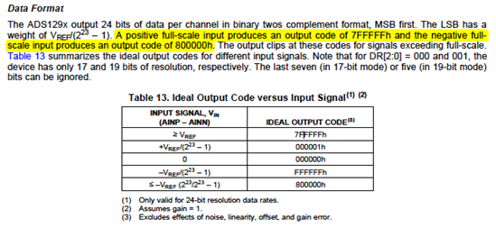

When I am using the same register settings for my Arduino code, I am facing a problem. (For simplicity, I am only reading back Channel 1 now). The data that I am constantly getting for channel 1 is 0x7FFFF. According to the following image below, 0x7FFFF means that I have exceeded the range. My assumption is that my ADS1298ECG-FE is currently reading a signal that is above its allowed range (i.e. it is saturated?).
Is there something that I am doing wrong? I tried changing the gain from 6 to 1 via the appropriate registers but to no avail, I still get 0x7FFFF.

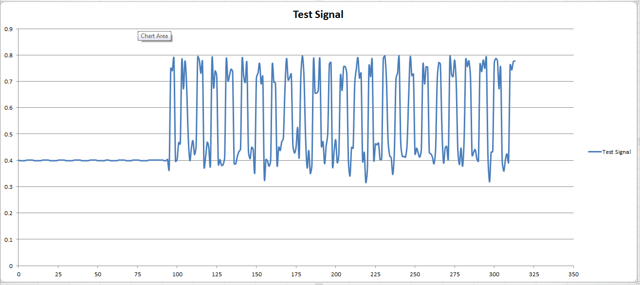

Earlier, I tried generating internal square wave test signals and have been more lucky as opposed to normal electrode measurement. This is the result of my internal test signals. I'm not sure if why it isn't a perfect square wave but I can guess that it may be due to the manner in which i save/post-process the data sent back to my computer.
I don't know if this is correct, or it happens to look a little like a periodic square wave by chance. However, it seems better than the 0x7FFFF from normal electrode measurement.

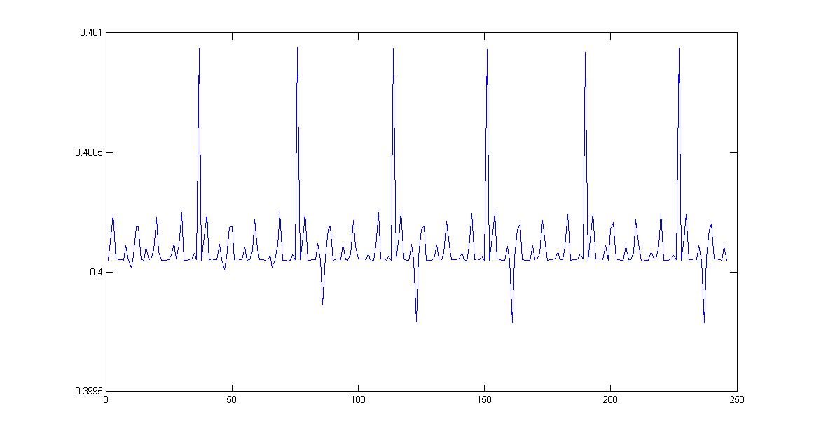

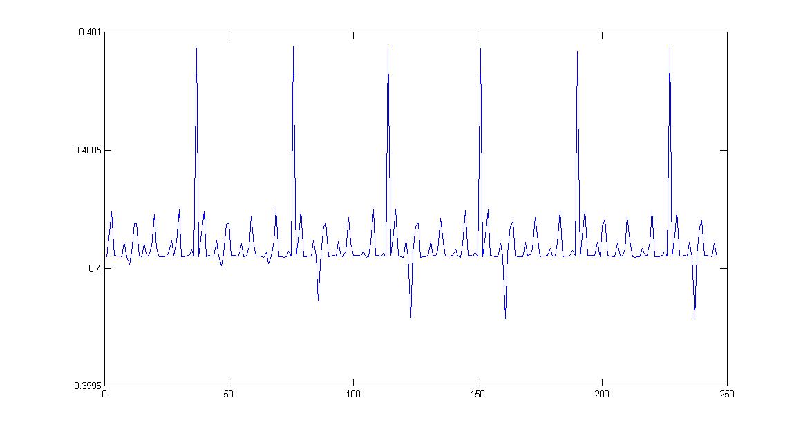

    This is the data for Channel 1. I'm currently sending data from my microcontroller to the PC via the serial terminal, which takes time. As a result, I suspect that I am losing samples, resulting in an inaccurate waveform.
