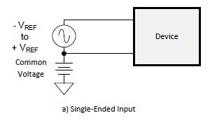

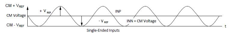

We need to use the ADS1198 FEA as an ECG unit in a single-ended input configuration; despite of TI recommendation for differential input mode for optimal operation.
1. What absolute percussion should be taken in using Single-ended?
2. If this SOC is supplied by 3.3 V battery, can the internal VREF of 2.4V be used as the input DC bias (Common Voltage), regardless of not being the midpoint bias?

    1. In a single-ended configuration, the negative inputs (INxN) should be tied to a common-mode voltage, preferably mid-supply. The positive inputs (INxP) should swing around the same common-mode voltage. Please refer
    2. I do not suggest using the internal reference buffer amplifier to drive the DC common-mode voltage without buffering it again. The internal amplifier will have a limited drive capability of only a few hundred uA at most.
