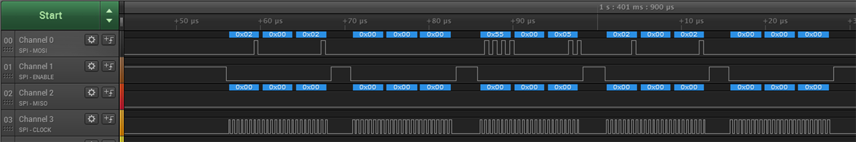

Hey guys, I'm trying to communicate with a DAC7760 over SPI and running into a few issues. As a basic test, here's what I'm trying to do after applying power:
1. Read the Control Register
2. Configure the Control Register for 4-20mA output
3. Read back the Control Register for verification
Here's a logic capture of the transaction:
SCLK is running at 2MHz, and as far as I can tell, none of the timing should be coming close to stretching the DAC7760's specs. The SPI driver is configured with CPOL = 0 and CPHA = 0, and it looks like this matches what the DAC7760 datasheet expects for incoming data. The driver also uses conventional CS control, where the DAC7760 uses the LATCH input in a slightly different way. Still, the description of LATCH makes it seem like driving it just like a regular CS pin should work, with the exception being that falling edges of LATCH are more or less ignored.
Are there any issues with this? Any help would be appreciated.
