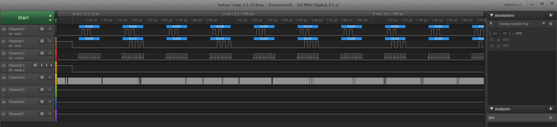

I am trying to establish a communication between MSP430 and ADS1258EVM board with more or less success. Based on the guide that you shared I have connected them with Jumper Wires but somehow the result is not that I expected.
Here is a screenshot of the Saleae:
I am trying to send any command (in this case 01010000 - Read Config0 Registed) and the result is always 0x15. This result is invalid ( the last bit must be 0 all time). Moreover the MOSI values are not always the same... I sense some communication error but I have no clue what to do.
And here is the code that I use:

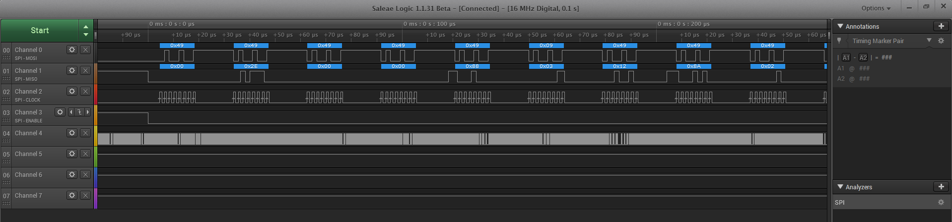

Here is another screenshot about ID Register:
