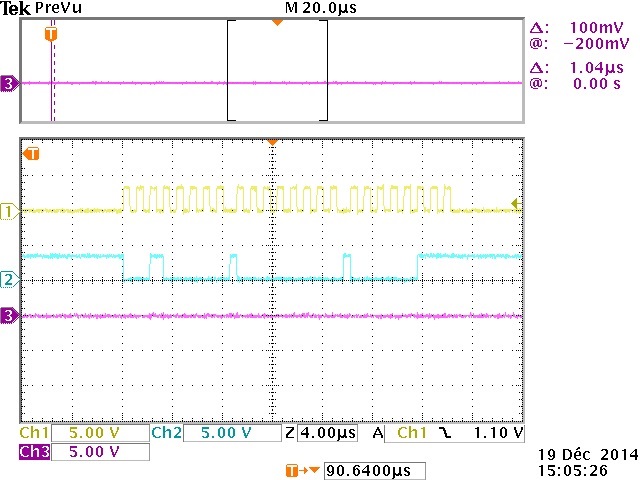

I'm using an ADS1248
/RESET is set to High
CLK is set to Low
START is set to high always.
I try to write a register and then immediately read it, but MISO stay always low then read data is always 0!

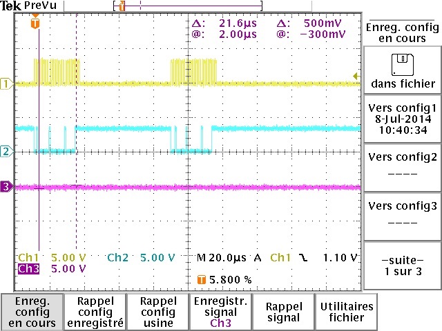

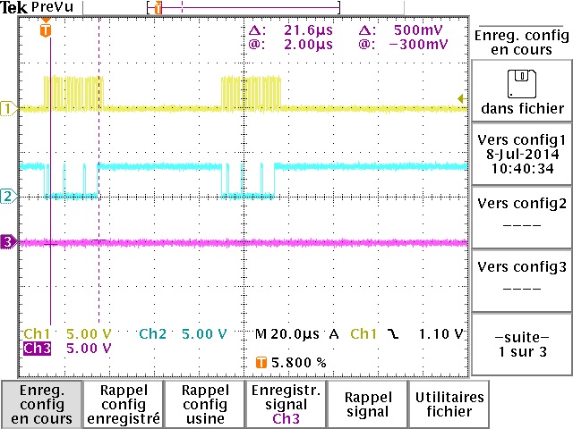

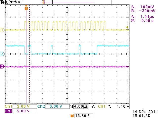

I send command SPI 0x40 0x00 0x07 to write 1 register MUX0 (Addr 0x0) value 7 (MUX_SN = 7, MUX_SP = 0)
Then to read I send  command SPI 0x20 0x00 0x07 to read 1 register MUX0 (Addr 0x0). Last byte is a dummy to read returned value.
Please find scope trace:
Yellow = SCLK, Blue = MOSI, Red = MISO:
Global.Jpg:  We can see the read and write sequence.
Write.jpg: Zoom on Write sequence
Read.jpg: Zoom on Read Sequence.
Please, Have you an idea why returned value is always 0?
PS I try to send a SPI CMD RESET and then waiting 600ms and then Write/Read. But this no change the result.

  • PS: CD pin goes low long time before clock oscillation..
  • A GIR,
    In general, your waveforms look correct. This version of SPI uses SCLK dwelling low, while DIN is clocked in on the falling edge of SCLK. The only thing that might be off would be that in your setup, the DIN line dwells high, but I don't think that would be a problem.
