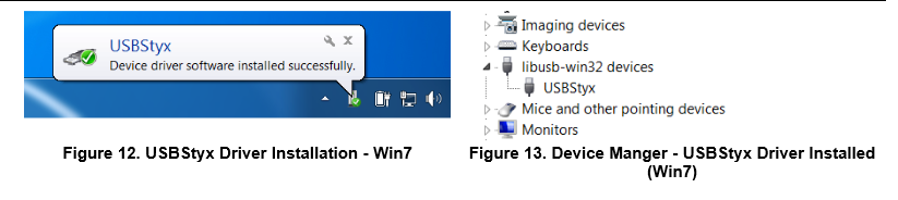

    I ran the software, but on the top side bar in the labview. the software said "no firmware found, downloading..", and " download failed..reset the hardware" right after appears..
    but I really installed firmware and software that ti provieded on the ads1299 catalog site. so i wander what is the problem and what i should fix?
  • Hello Minhee -
    Can you verify that the second driver installed properly?  It sounds like it may not have installed correctly.
    If the driver is installed correctly, you should see the below in the Device Manager after the firmware download.
    If you do not see the above, you can download the appropriate driver from the below links and run the separate driver installer.  Hopefully, this should fix you problem.
    Driver link: "ftp://ftp.ti.com/pub/data_acquisition/ADCPro2/misc/drivers/"
  • greg,
    thanks to your help. I installed USBStyx and exe file works properly.
    minhee
