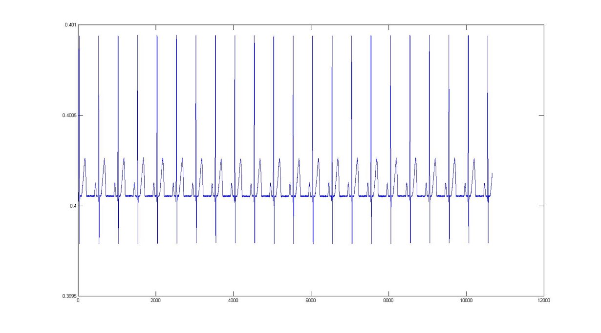

I am using an Arduino Uno and the ADS1298ECG-FE. I have managed to successfully read ECG data that is being generated by my ECG simulator. However, there are some things that still need to be ironed out.

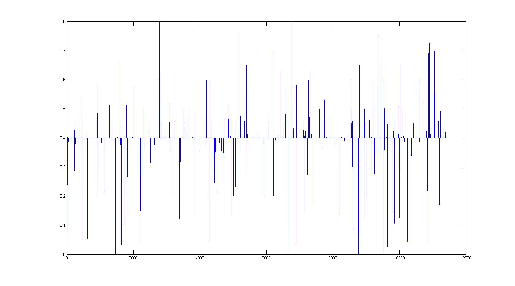

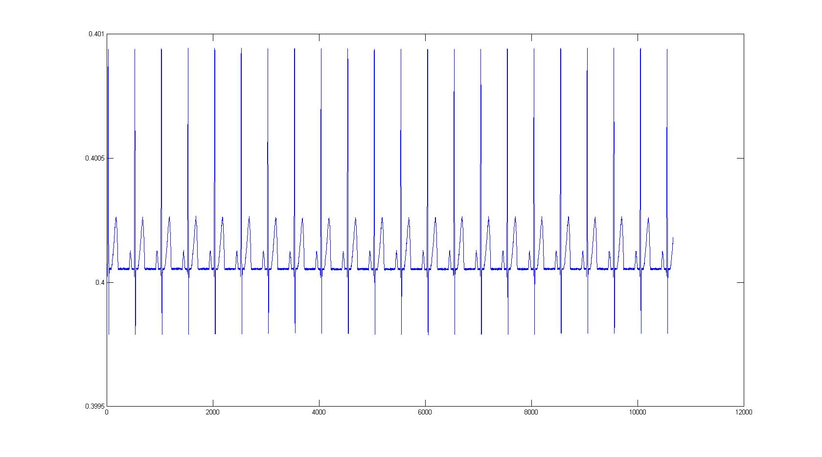

Out of the 8 channels, three are not working as expected: Channel 4, 5 and 7.
The following image is from Channel 1, which is working correctly
The following image is from Channel 7:
The channels 4, 5 and 7 yield the results shown in the second image. Respectively, they are V2, V3 and V5 leads. Since the other chest leads (V1, V4 and V6) are working as per normal, i don't think it has anything to do with the WCT configuration. Below is my register settings:
