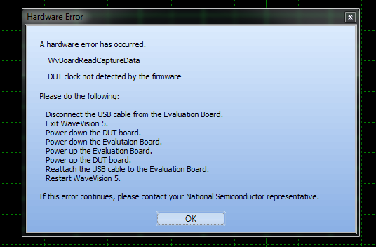

I took FPGA source code from ADC12D800RFRB Design Package and found that after synthesize and creation "Generate Programming File" on ISE Project Navigator, i cant program my FPGA. i have error: DUT clock not detected by the firmware!!! Perhaps because the version of the file wavevision used is adc12d800rfrb3 ???
System: WIN7-64bit; ISE Project Navigator 14.7

    Can you provide a little more information regarding which ADC12D800RFRB you are using? When you connect this board to the PC and configure it using the normal Wavevision5 software method, what is the text displayed when the "Loading xxxxxxx FPGA Image..." message comes up? Which board name "xxxxxxx" is being recognized?
    Also please make sure that the red LED near the power switch is illuminated before configuring the board. If the switch is off or the adapter is not properly connected the USB interface will still recognize the board but FPGA configuration will not work properly and other board functions will not be active.

    when i start wavevision, board name "Loading ADC12D800RFRB3 FPGA Image..." is being recognized and everything working fine.
    but if i take .bit file from fpga source code that you provide on the web and swap the new image for the old one on the directory: C:\Program Files\National Semiconductor\WaveVision5\hardware\fpga_images => wavevision not working. i have error: DUT clock not detected by the firmware...
    I think the problem in the version of the source code that you provide. maybe is it old version?

    Please find the source code for the ADC12D800RFRB3 attached.

    Thanks for the files but unfortunately these are the files that I have. WaveVision5 still does not work and gives me the same error.
    Can you please explain the difference between files ADC12D800rfrb and ADC12D800rfrb3?
    Again: I do not make any changes in the project and in the source code. I just:
    • сreate a new .BIT file;
    • copy it to the C:\Program Files\National Semiconductor\WaveVision5\hardware\fpga_images;
    • change the name of the new file to the adc10d1000_xc4vlx25_adc12d800rfrb3.bit;
    • connect the board;
    • run WaveVision5;
    • WaveVision5 finds the hardware, loads FPGA image
    • and when I press the green button (Acquire continuously) I get a hardware error: WvBoardReadCaptureData, DUT clock not detected by the firmware...

    This sounds like a problem that another user was experiencing: http://e2e.ti.com/support/data_converters/high_speed_data_converters/f/68/p/348949/1224932#1224932
    Try to toggle between external and internal clock to see if this can solve the problem.

    I tried to toggle between external and internal clock in the WaveVision5 but I still have this problem. I also tried to use the files that you have attached below but it didn't help...
