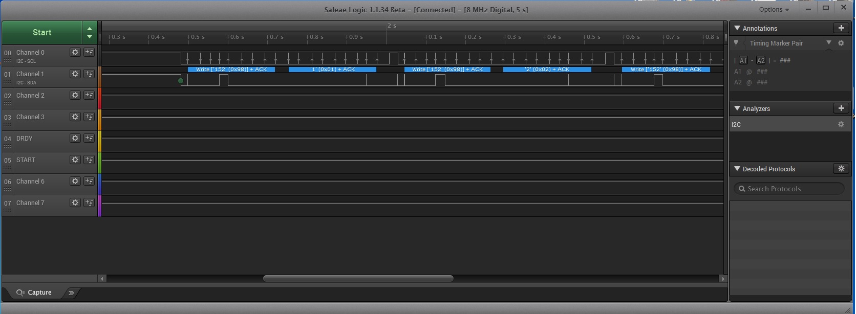

    I have modified the above code only 2 times as I marked.  Here is the Saleae result:
    I am in trouble. The Clock does not seems so good but I dont know why.
    I have mentioned my problem in this link but I think you can only help :)
    I think the problem should be here:
    GPIO_setAsPeripheralModuleFunctionInputPin(GPIO_PORT_P3,GPIO_PIN0 + GPIO_PIN1);
    But when I replace it to these:
    GPIO_setAsPeripheralModuleFunctionInputPin(GPIO_PORT_P3,GPIO_PIN0);
    GPIO_setAsPeripheralModuleFunctionOutputPin(GPIO_PORT_P3,GPIO_PIN1);
    The outcome is worst...
    Any idea?

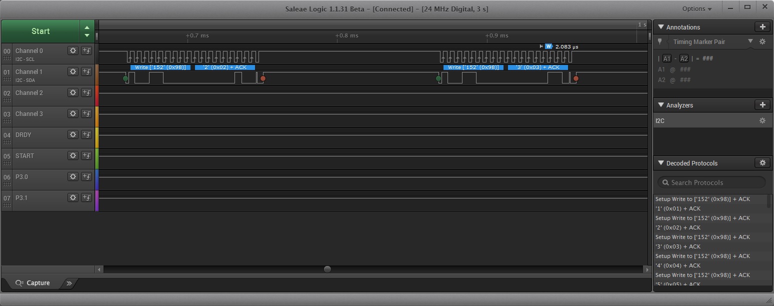

    UPDATE: I set the DAC address value, then I can read ACK after my messages.
  • Hi Daniel,
    No problem! Let me dig deeper into this on Monday... I have some hardware that I can try this out on.

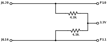

    Currently, are using pull-up resistors?
    Chris
    Thank you for your effort in advance. I am looking forward any outcome!
    Anyway, I have applied two 4.3K resistors on the I2C wires.
    It seems working very well.
    Have a nice weekend!
  • Hi Daniel,
    Great job beating me to the answer!
    It turns out I was mistaken in one of my previous posts, the external pullup resistors are required. The internal pullups only work in GPIO mode. See the following thread for more details on this:
    I was able to add pullup resistors to the ADS1258EVM and run your code, the only change I made was to the I2C address:
    #define SLAVE_ADDRESS 0x4C
