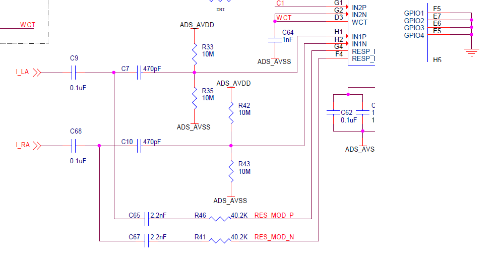

We are interfacing MSP430BT5190 with ADS1294R using a custom board.
For testing we are using Nettech MiniSim ECG simulator.
We are able to get the ECG data, but unable to get respiration data.
measurement using Internally generated MOD signals ( RESP[1:0] = 10 ), 250SPS, low power mode, 135 degree phase shift, 32KHz modulation clock.
When i collect the data on channel 1, i am getting all zeros.
Any suggestions?

    Thank you for your question. Can you please share some more details about your ADS1294 circuit and the simulator settings you are using for the respiration measurement? A schematic and a list of register settings for the ADS1294R will be helpful for us to get started.
    Have you been able to read any data on Channel 1? Have you tried using another signal source, such as the internal square wave test signal?
    Please find the circuit for respiration measurement.
    Following are the register configurations i am using.

    I checked your register settings and two things caught my attention. First, you have CONFIG2 = 0x00, meaning the internal test signal is disabled. Are you providing an external signal to the TEST_PACE_OUT pins? Second, you have CONFIG3 = 0x40, meaning the internal reference is powered-down. Are you supplying an external 2.4V reference?
    The respiration modulation clock signal is mostly filtered out in the digital filter (-3dB cutoff = 0.262*fDR), but you might be seeing some of that signal alias into the passband. For quick device evaluation, customers will have this feature disabled in order to measure a clean test signal like in your last post.

    It looks like you are close to capturing the respiration waveform. As you mentioned, it is generally more sinusoidal than what your image shows. You may be missing data samples. Verify that you are reading data with each /DRDY pulse and that you are able to finish reading the 24-bit STATUS + (4 x 24-bit channel data) before the next /DRDY.
    By the way, CONFIG2 [7] must always equal 0.
    You mentioned that you are driving an external test signal, but it is unclear to me why this is necessary when you are measuring respiration on Channel 1. Regardless, it should not interfere with your measurements if MUX1[2:0] = 000.
