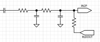

    2. In this application, are the electrode inputs AC coupled? Typically, if a 3rd electrode is not available for the RLD, the electrode inputs are AC coupled and the DC bias is provided by either:
      1. a resistor divider between the supplies.
      2. a pull-up resistor to RLDOUT.
    Using a pull-up resistor to RLDOUT should still help improve CMR.

    Also, regarding RLD, do you have a reference schematic which shows an implementation of pull up to RLDOUT?
    How to calculate value of pull-up resistor?
    In this case, where to connect RLDIN/RLDREF?

    2. For example:
    Keep in mind that the value chosen for the RLD pull-up resistor will form a high-pass filter with the DC blocking cap in series with each electrode. 10M to 100M ohms should be fine.
    3.  RLDIN/RLDREF is not needed if RLDREF_INT = 1. This will set the common-mode of the RLD amplifier to mid-supply.
