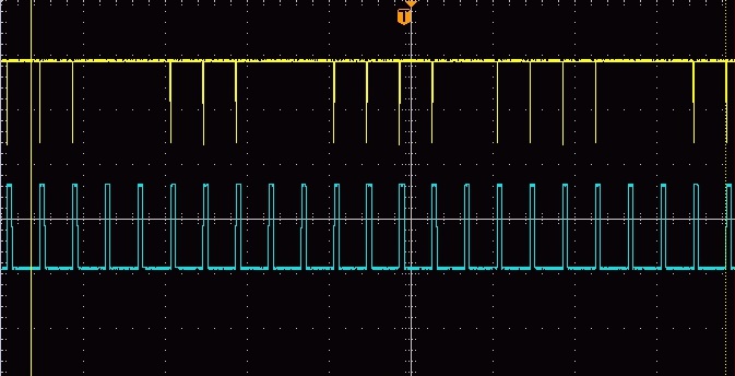

I am working on MSP430BT5190 and ADS1294R.
ADS1294R is configured for continuous mode(RDATAC), 250SPS.
I am able to collect the ECG data on channel 3. From the waveform it looks like i am missing some of the samples.
So i connected the DRDY  and p4.7 (flag to make sure i am reading the data) to CRO. Following is the snapshot of the CRO.
After every 3 or 4 cycles, one or two DRDYs are missing and i am still reading the data, which is wrong.
yellow-->DRDY
blue-->DataRead(P4.7)
What might be going wrong?
