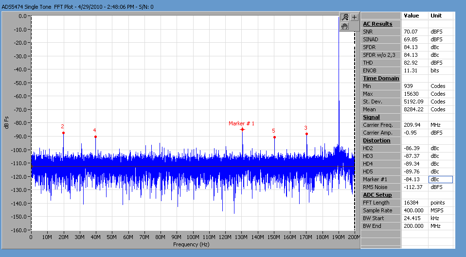

ADS5474 on my board is clocked at 400MHz. When I analyzed the data from ADS5474 using FFT, I noticed that the noise floor is not flat. The noise floor is sloped down from DC to 200MHz. The noise floor at the DC end is higher than the 200MHz end for about 5dB. Why the noise floor is not flat? What makes the noise floor sloped down?
