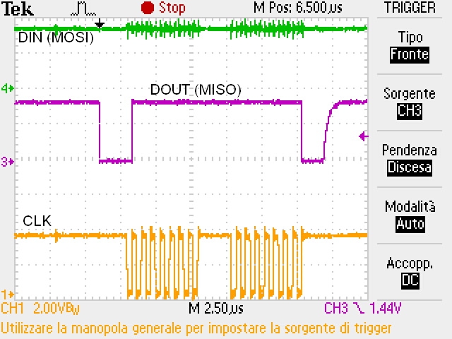

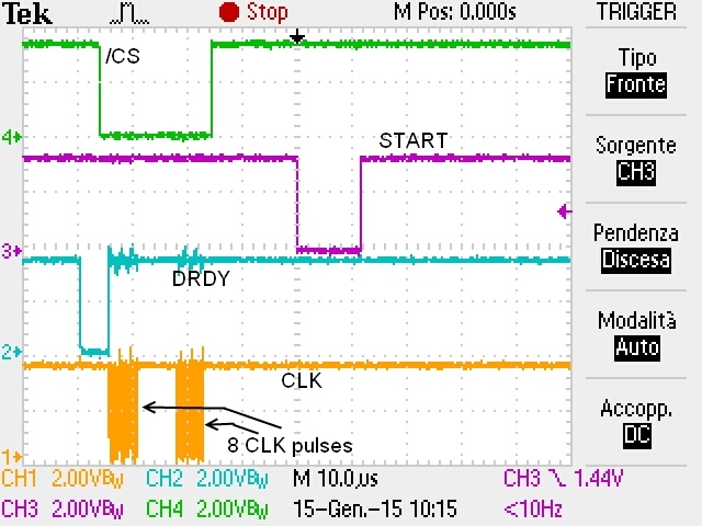

    Here there is the behaviour  of the CLK, DRDY, STARD and CS signals:
    Looking the shot, it seems that the START pin is toggled BEFORE the communication, but I think it is from the following cycle of operations . I can't show in the same shot the propper START pin going low and high.
    Below I show the DIN and DOUT in respect with the CLK
    On the DOUT pin I can see something, perhaps the NOP bytes, but on the DIN pin I'm not able to see anything..
    May I forgot some passages or did any mistakes?

  • Andrea,
    Make sure the SCLK dwells low (that SCLK starts low and clocks up for a pulse). It is not set up that way according to the scope photo.
    It might affect the data clocking out and clocking in register values.
    Joseph Wu

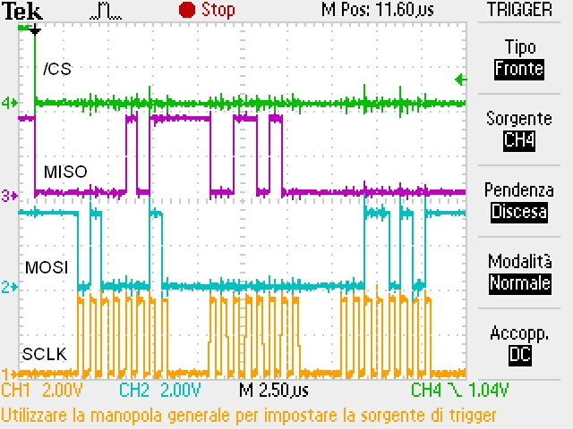

  • Joseph,
    1. yes, you are right about the behaviour of the SCLK when idle: I modified the SPI initialization, and the new scope photo of the communication is shown here:
    2. but now I have a doubt: I'm trying to measure an external VREF (about 1,5V) between REFP0 and REFN0 of the ADS1148; in order to write the configuration registers, I write the MUX1, IDAC0 and IDAC1 registers, at the address 02h, 0Ah and 0Bh rispectively. To do this, I send the WREG command and after that the single byte through SPI, and repeat it for three times, in this way:

    After that, I want to start the communication (toggle START pin, wait for DRDY to go low, send RDATAC command) and receive the measured VREF voltage an the REFP0-REFN0 pins, but if I trigger the oscilloscope on the MISO signal (DOUT), I can see data that don't make sense. My VREF (REFP0-REFN0) is about 1,5V (measured with a multimeter), but the reading of the oscilloscope doesn't match with it. Perhaps the configuration is wrong? Have I to configure other registers?
    my steps in this step are:
    • pull the START pin low and high
    • while cycle to wait the DRDY to go low
    • /CS low
    • send RDATAC command through SPI
    • send 0xFF through SPI
    • receive a byte from SPI
    Could anyone tell me what I'm doing wrong?

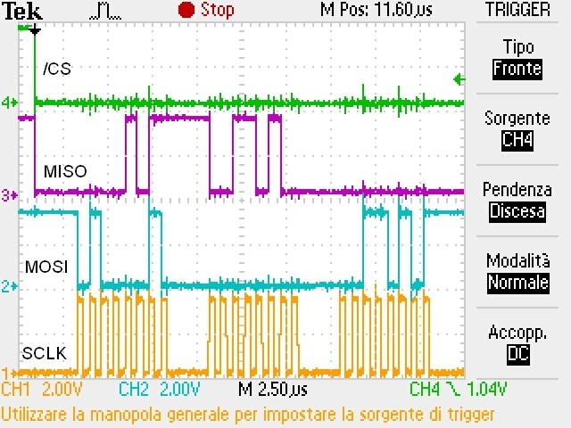

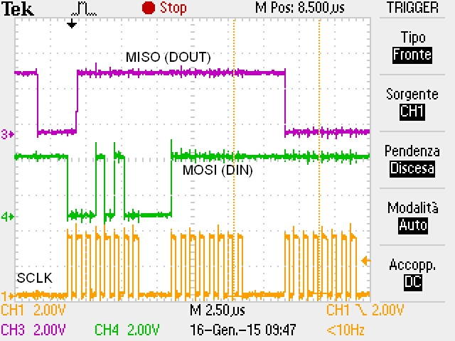

    Here is the scope photo of the communication:
    Many thanks!
  • Andrea,
    Thanks for the scope shot of the communication. It was important to get the SCLK in the right format. For the first shot, it looks like 14h followed by two NOPs which would be RDATAC. In your system, I don't think you need to issue that command, because RDATAC is the default mode of getting data. It doesn't hurt to leave it in, but it's not necessary. Once the /DRDY goes low, you can simply send the NOPs to get the data value back. The data is ready to be clocked out of the DOUT register.
    Looking at the code you provided, it looks correct for what you are doing. The last scope photo shows the sequence of 42h 00h 35h, for setting the single byte of the MUX1 register. That should set the internal reference always on, the onboard reference selected, and a measurement of the external REF0/4 as mentioned in Table 17 in the datasheet. Measure REFOUT to GND to make sure that the external reference is correctly at 2.048V
    With that setting, you should have an output data of:
    ((1.5/4)/2.048V)*2^15 codes for the output or about 6000d, or about 1770h.
    If you do not get this value, what value do you get?

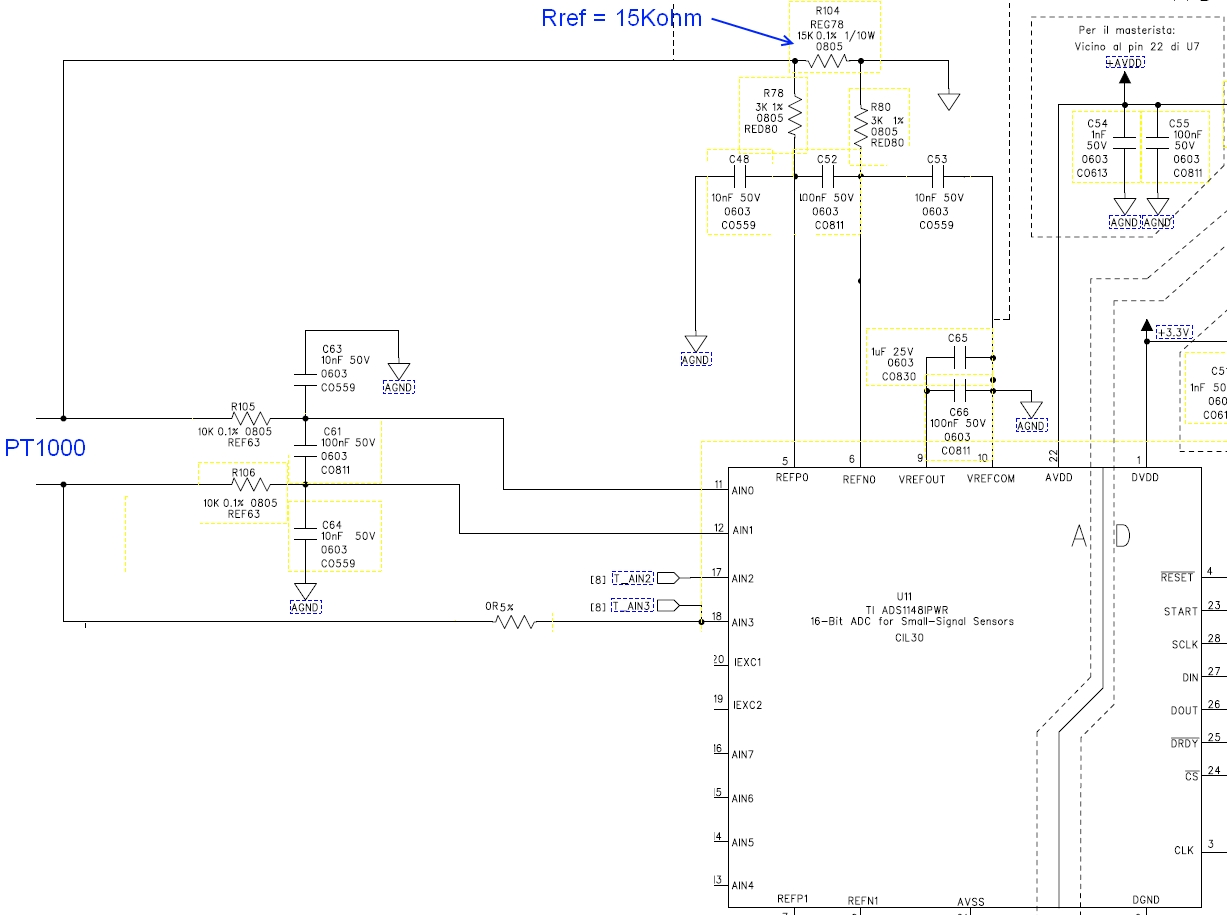

  • Joseph,
    this is my schematic:
    • The reference resistor is 15Kohm, I selected an IDAC value of 100uA, so the Vref (REFP0-REFN0) should be about 1500mV (and I can read it correctly with a multimeter).
    • I thought the IDAC current should be routed to AIN3 because, looking at the schematic, that current flows through the PT1000 and generate a voltage differences that I can measure between AIN0 and AIN1. Is it correct?
    • For example, a resistance of 1,7Kohm is connected to the inputs, simulating a PT1000 value. Measuring the voltage at the inputs with a multimeter, I can read a voltage of 160 or 170 mV. Running the program, the ADS1148 reads a value of about 0xC6A3 (50850d). I think it is not correct, because this value corresponds to a voltage of: Vin=Vread*VREF/(PGA*32767) = 50850*1500/(4*32767)=581mV , that is different from 170mV I measure on the board. Perhaps there is any error in the formula I used?
  • Andrea,
    Based on the way you have it set up, it is ok that the IDAC is sourced from AIN3. However, notice that the current will make the AIN1 node higher than AIN0. If you have the default measurement of AIN0 as positive and AIN1 as negative, then the voltage you read will be a negative value.
    Note that a negative value is represented in twos complement notation. In your reading, you get C6A3h which is -14685d. Note the data format explained on page 30 of the datasheet.
    Using this, you can calculate the measured value (ADC data/2^15)*(VREF/PGA). Note that full scale is -VREF/PGA to +VREF/PGA to get 2^16 bits. (and 0V to +VREF/PGA for half the full scale to get 2^15 bits).
    Measured value = (-14685/2^15)*(1.5V/4) = -0.168V.
