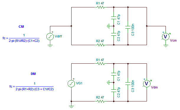

    Q6. When referring "Figure 70. Geophone Interface Application" on datasheet page 42, we found 100ohm resistors (R1 to R4) and 10nF capacitor (C4). We assume that this differential filter is aimed for low pass filter not anti-aliasing for input signal and depending on sensor type we use.
    Since we would like to make sure how to calculate correct cut off frequency, please let us clarify how we could find out any formula.
    We assume that the cut off frequency when using these components would be 39.7KHz, based on R=Xc=400ohm.

    Q6)
    The filter shown in Figure 70 provides both common-mode and differential signal filtering. The cutoff frequencies are given by the equivalent RC filters for each mode. Here is the standard form of this filter with the equations for the cutoff frequencies:
    For the exact cutoff frequencies of the filter in figure 70, you’ll need to run a simulation to figure it out. The equation is not so simple because the second filter stage will have a loading effect on the first filter stage. You’ll also find that resistors R3 and R4 will further reduce the differential cutoff frequency, without reducing the common-mode cutoff frequency (ignoring the loading effects).
