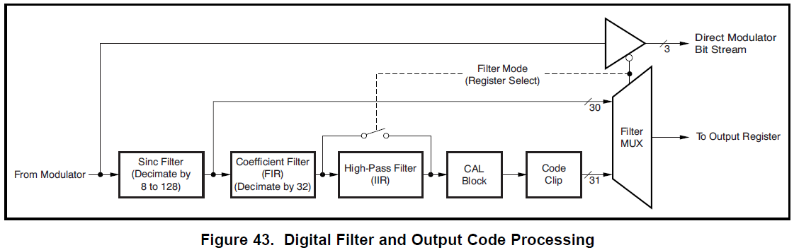

We are currently using ADS1282-HT and running into some problems.  After lots of research thru the forum, we are able to get the chip to read the data by command.  Currently we are stuck in the OFFSETCAL & GANCAL.  Note that we are trying to follow Figure 66 of the spec.  Plus, input MUX was set to 100 where AIN2 was connected to GND to generate the zero input for OFFSETCAL..  Here is our sequence -

    First off, which filter mode are you using on this device SINC or FIR mode?
    From your timing measurement of RDATAC to /DRDY low, it would seem like you are running in SINC filter mode. In SINC filter mode, running OFSCAL and GANCAL will not be of benefit to you. The internal calibration block will only be useful in FIR filter mode. The calibration block is bypassed  in SINC mode (see the filter diagram below), and output data will not scale according to the OFC and FSC register data.
