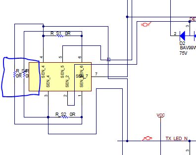

I was planning to run the AFE4400 using only 3.3v. For this I changed the source voltages to 3.3 volts. I am using NJL5310R as the sensor.
I have also made few PCB's to test it out.
But the problem occurs when I try to run my HRM code on the board using MSP430F5529 launchpad. (However the same code works perfectly with AFE4400SPO2EVM connected to NJL5310R(board with DB9) provided by TI)
On multiple tests the result was same. I sent the recieved data to matlab for visual analysis and found the data to be vague. I cant seem to find the pulse signal in the data.
My suspects lies with the fact that maybe the circuit that i modified is wrong or the 3.3 need to be highly filtered as done by EVM.
I am attaching the PDF containing my circuit design.
Plz have a look at it and suggest some methods.
PS. the 2 resistor connected by lest of NJL sensor are DNC( Do not Connect)AFE4400EVM_page2.PDF.
