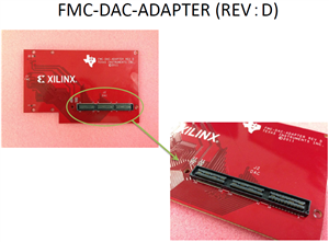

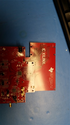

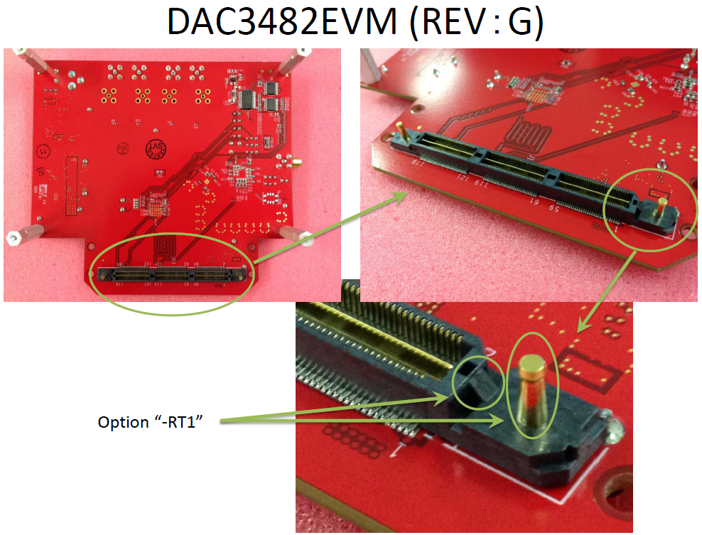

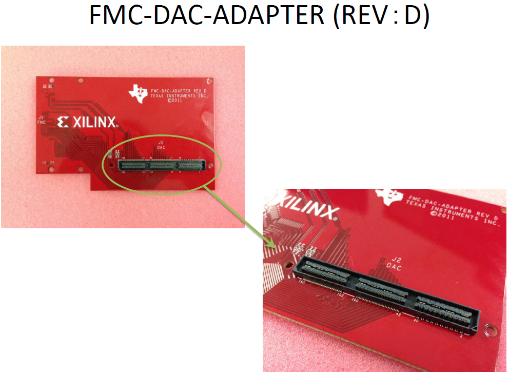

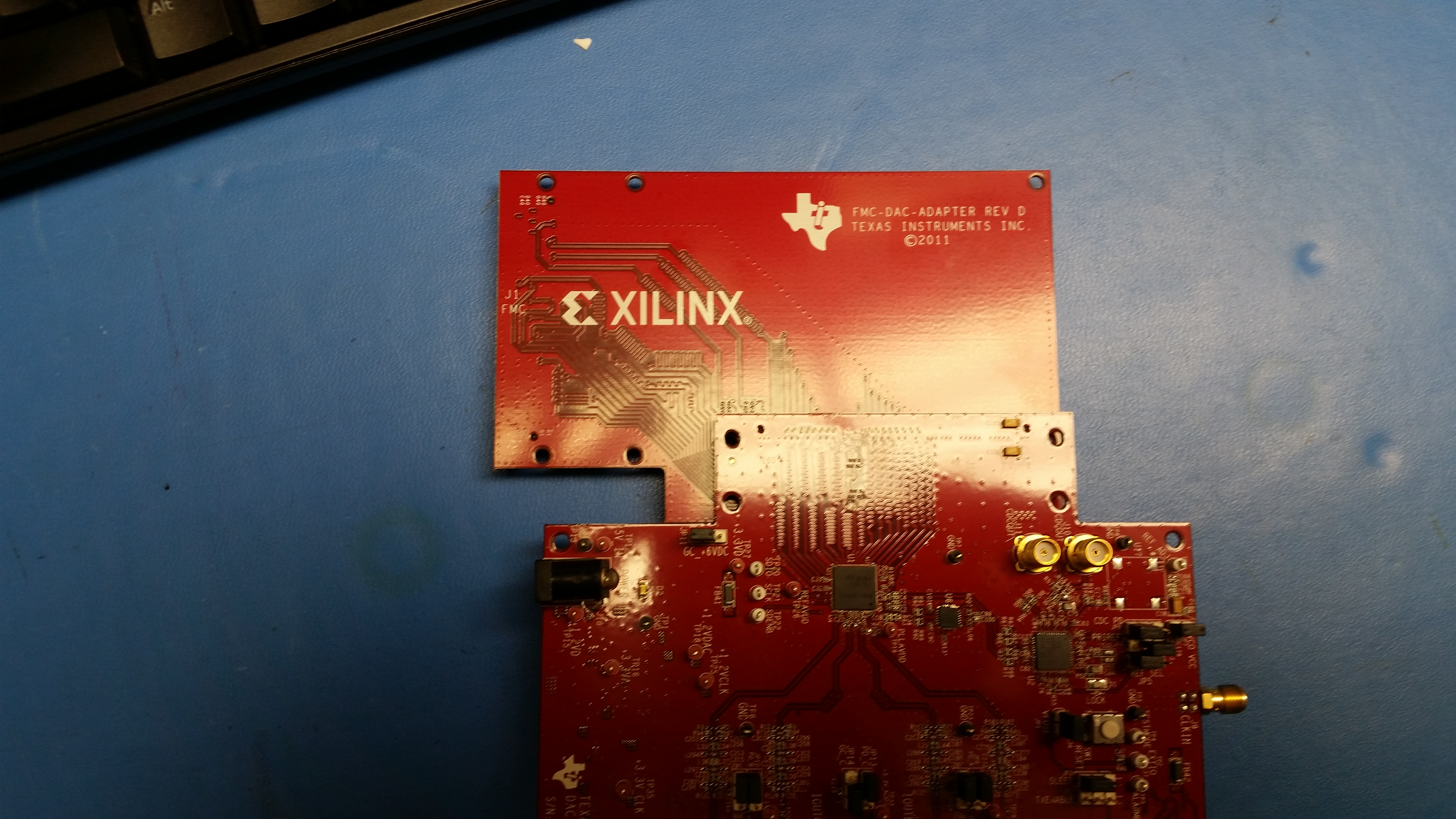

My customer received DAC3482EVM and FMC-DAC-ADAPTER and he tried to connect them, however he said J13 connector of DAC3482EVM and J2 connector of FMC-DAC-ADAPTER didn't match.
I found the following description in DAC3482EVM User's guide.
Is the following description wrong?
[User's guide page.2]
The on-board HSMC connector input allows direct connection to the HSMC compatible Altera development platforms, and the externally attached FMC-DAC-Adapter board available from TI enables the connection of the EVM to the Xilinx development platforms with FMC headers.
What can I do for my customer about this issue?
