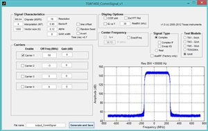

Using TSW1400 to generate QAM, how do I control symbol rate?
I am trying to use the TSW1400 Waveform generation software to generate a simple QAM64 pattern on the TWS38J84EVM board.  The Bandwidth of the QAM outputs that in generated  stretched to the full bandwidth of the DAC.  Which is way huge in this case.  I need to run a smaller bandwidth pattern but a high sample rate, like a QAM64 in 10MHz of bandwidth,  How can I get the software to do this?  I have App note SLWU082 but it has no examples on QAM Shot of my TSW1400 software generator screen attached show how the qam got stretched to 400MHz of bandwidth.
