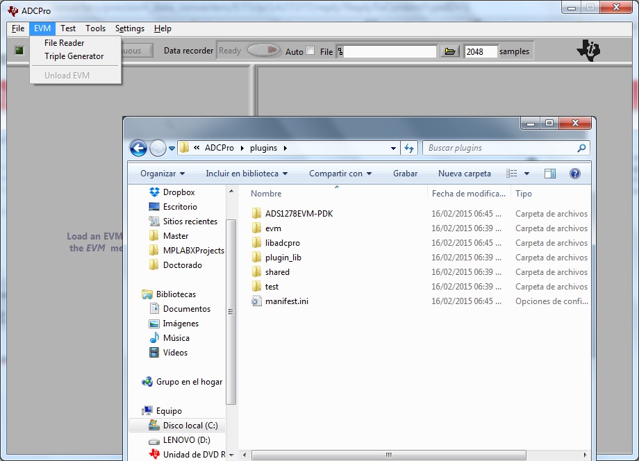

I've installed ADCpro v2.0.1 and the ads1278 plugin (from an ftp ti webpage v1.2.4) but I'm unable to use the plugin in ADCpro. According to ADCpros´ user guide, when opening the application I should be prompted with a the "General tab" window, instead I get the Splash screen and then the initial ADCpro screen from which I can only access the EVM and Test plugins.
What am I missing? I've already viewed other posts regarding adcpro installation problems (not all of them) and haven't found a solution.
As a reference, the ads1278 plugin was installed on the directory C:\Program Files (x86)\ADCPro\plugins\ADS1278EVM-PDK ... should it be installed in another directory so ADCpro can understand that it's installed?

  • Hi Greg,
    I have already read the user guide and I know the launcher is disabled, that much is clear, yet when I'm in the main app screen (Figure 8) I'm unable to see or access the ADS1278 plugin eventhough the plugin is installed (see attached).
    Is there an issue with the versions I'm using? I have already uninstalled and reinstalled everything with the same outcome.

  • Hello Carlos -
    With another look at your screen capture, something looks off. The ADS1278EVM plugin information should have been installed one folder further down.
    You can try moving the entire folder 'ADS1278EVM-PDK' into the 'evm' folder. You then should have '...\evm\ADS1278EVM-PDK\...' Not sure why the installation was in the wrong location, but this should fix things.

  • Hi Greg,
    For your first message... Yes I installed ADCPro first and then the plugin. I'm using windows 7.
    For the later... I tried moving the ADS1278EVM-PDK folder to "evm" but it didn't work. I got prompted with an error message saying there was an Invalid Plugin INI File... but that got me thinking that the issue might be the ads plugin. I started testing several ads plugin versions until I got one that worked properly and got installed in the "evm" folder.
