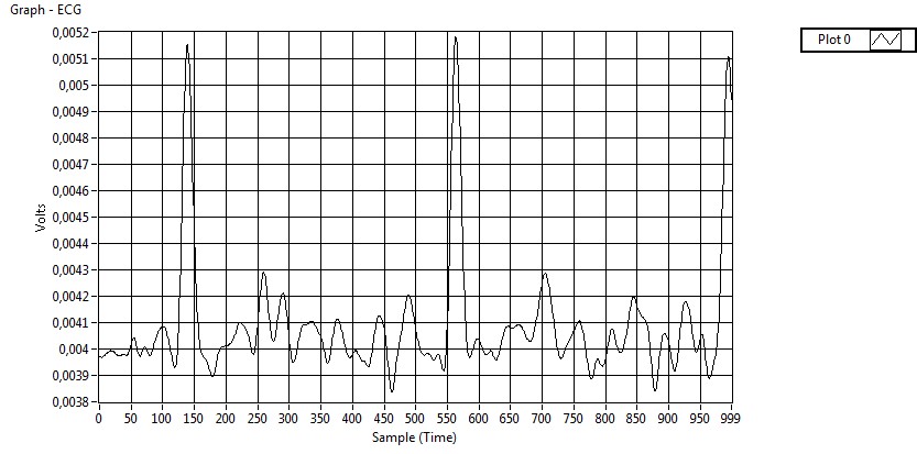

I am testing the ADS1292R Demonstration Kit and I need help.
I am using the RA, LA and RL electrodes on my chest and the AFE registers are with the default configuration.

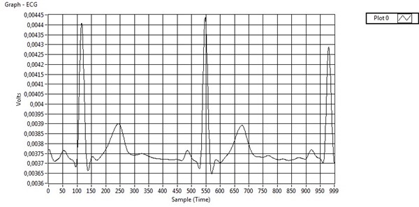

The problem is that the ECG signal is noisy, and when I touch the DB9 connector shield it gets perfectly clean.
Is there a mistake in the RLD configuration? Any ideas?
See the attached images.
Thanks.

    The situation is simple: I connect the LA, RA and RL electrodes (Covidien) to my chest, connect the board to the PC, open the GUI and check the signals. They are noisy. When I touch the DB9 shield or any ground point, the signal gets clean.

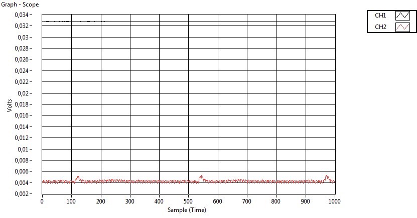

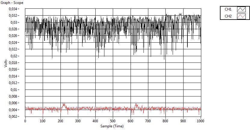

    See more images below: in the Scope Tab, the channel 1 is noisy. When I touch the ground it turns flat.
    What is wrong ?

    Remember that Channel 1 is configured for Respiration measurements on the ADS1292REVM. The signal path includes multiple DC-blocking capacitors and a 10M resistor divider to set the DC common-mode. I would disable the respiration modulation/demodulation signals in the RESP1 register and focus on reading data only from Channel 2 for now. You can use Pin 1 of the DB9 for RA and Pin 3 of the DB9 for LA. This will connect your inputs to IN2N and IN2P, respectively.
    I still believe the noise you are seeing is likely 50/60Hz noise. The ADS1292R EVM does not automatically filter this noise out. You can apply a high-order notch filter in the GUI to a set of data points after the collection is finished to view the effects of the filter. If possible, you can try running the PC off the battery supply.

  • Ryan,
    After removing the DC plug from the laptop everything was resolved.
    Thank you for the support.
