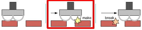

Which is the switch timing of MUX for ADS1120, "break before make" or"make before break"?
If it is "make before break", how long is channels connected?

    The mux changing of MUX for ADS1120 is "break before make", isn't it?

    Yes the mux is break before make.  This is a very fast process, so I doubt that the issue is directly related to the mux.  Based on your settings, I think that the PGA may be in an overloaded state.  This can happen if the PGA is still at a gain of 64 when you switch from ChB to CHA.  In theory, the switch of both the mux and the PGA should happen within a couple nanoseconds of each other and this should not cause an overload.
