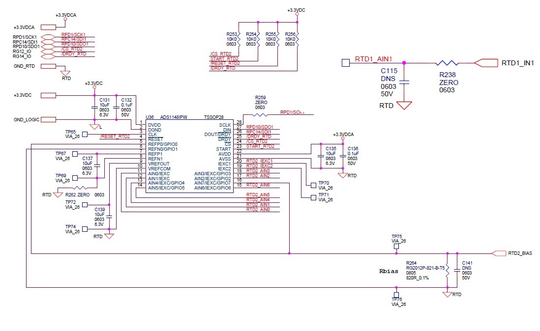

    Here's the schematic for our RTD circuit. Taking the data for a voltage vs output table would take some time, so I figured I would start of with just the schematic.
    Other settings I may have missed: 2ksps, usually a Gain of 1, and excitation of 1.5mA, but we have reproduced this behavior across various Gain and Excitation settings.
    To simulate an RTD sensor, we wired a 1kPot between AIN5 and AIN7/REFP0.
    -Devon

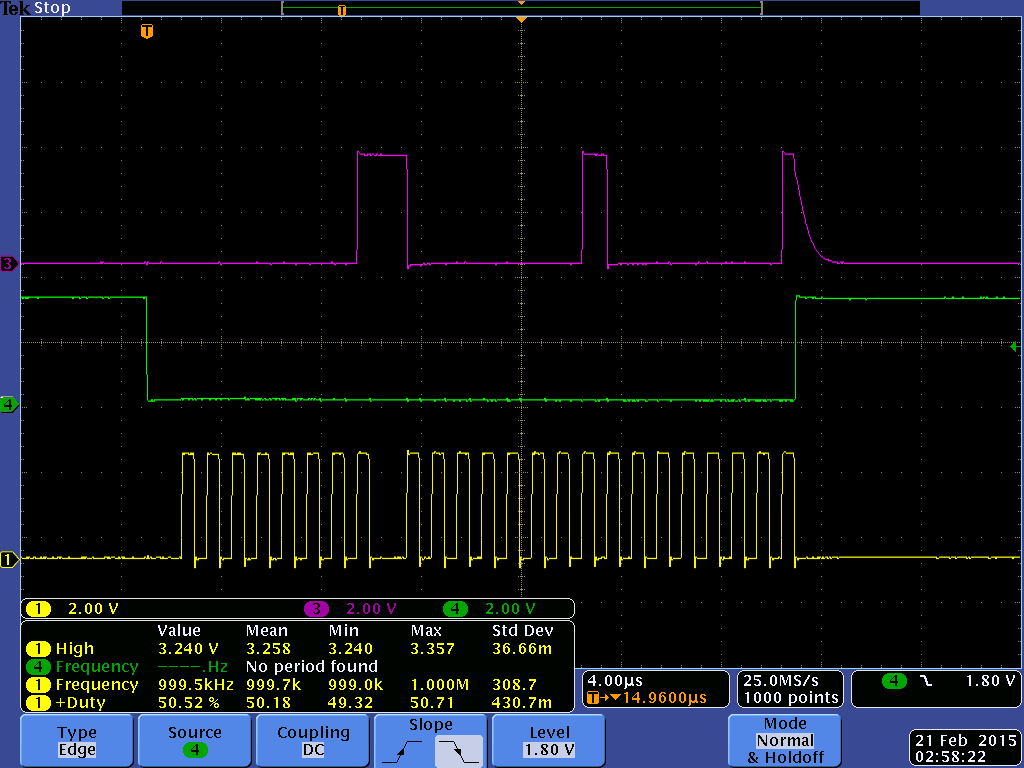

    I'm still looking at the schematic, but do you have an oscilloscope to show the data transaction? I'd want to see the /CS, SCLK, DIN, and DOUT for a data read of a good and bad case.

    Also I have attached I hand drawn schematic of how I have my 1kpot hooked up (Amar and I are on two different set-ups).02191501.PDF

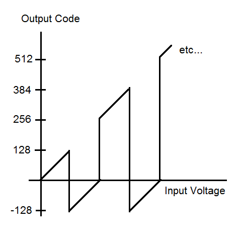

    Just to be clear, is this what you are seeing?
    After that, the pattern repeats all the way up to full scale (output code=32767)? How do you extract the data? Do you do any manipulation in the read to account for 2s complement notation?
    At this point, I'm assuming that you are looking at one channel (I'm going with Devon's AIN5 to AIN7), then sourcing current from AIN5 to sink through Rbias, which is connected to AIN7. Assuming that there are no leakage currents, then all of the current (1.5mA) through the pot should also go through Rbias.
    With the IDAC current at 1.5mA, voltage across the Rbias should always be 1.23V. For the pot, it should go from 0V to 1.5V, but the data should overrange at the same 1.23V when the pot resistance is 820Ohms, same as Rbias. I assume that you're not changing channels and that you're reading the inputs based on the input value and not through the sample and hold devices on the front end.
    Let me know if I've missed anything in the explanation.

    Your function graph shows what we are seeing with data output.

    I was able to discover our issue after I more closely analyzed to SPI Bus.
    To extract data reads we were us a READ command, and then collecting the next two bytes by sending NOPs. Since the ads1148 defaults to continuous data mode, it was clocking out the MSB of the data read while we sent the READ command.
    Here' s a a scope shot (CLK = yellow, CS = Green, DOUT = Purple). This shot captures right when I passed over the 127 DOUT threshold.  It seems when the DOUT clocks out the data MSB the first time, it preemptively sets bit7 of the LSB. Then we we try to read the MSB after out READ command, we latch on DOUT before we should, getting a 1 for the high byte of the read. Folow two's compliment rules and that explains our negative reads.
    We are most likely running an innapropriate SPI Mode, and need to latch datha on CLK low, not CLK high. I guess it would be nice if the SPI Mode as well as rate was explicitly stated in the datasheet. Either way I was able to solve this by just reading in the data without first sending a READ command.

    It looks like you're on your way to getting some good data. I would like to point out a couple things. Most of the communication specs are shown in the tables and diagrams on page 12 of the datasheet. Based on the scope shot, you'll also need to observe the tSCCS (SCLK low to /CS high). It looks a bit short.
