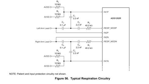

Hello All,
Please suggest us how to provide patient protection in configuration attached.
In the configuration we are providing protection to patient through R1, R2 as well as series capacitors for dc current for respiration channel only.
But in above circuit we are not providing protection to patient from ECG channel(IN2P and IN2N). We are using only 2 electrodes for ECG and same electrodes for respiration.
We have referred sbaa181.pdf for providing patient protection for respiration channel.

  • Hello Mahendra,
    The Channel 2 ECG path is simplified in Figure 56. Normally, input low-pass filters would still be included for anti-aliasing on the ECG channels, while the Respiration channel would look as shown in the figure. The series resistance from these low-pass filters would provide some protection from DC current to the body. As Todd mentioned, you can find an example how the two input signal paths are different in our EVM User Guide.
    Additional patient protection may still be required for the electrode inputs, such as TVS diodes. This protection would only be required for each electrode input, not necessarily each device input. So in this configuration, RA and LA are shared by Channel 1 and Channel 2, but diodes would probably only be needed to the left of the diagram in Figure 56 (where you see "Left Arm Lead" and "Right Arm Lead").
    Apart from these suggestions, our team cannot comment on specific patient protection designs. It is up to the customer to ensure that their design meets IEC specifications.
