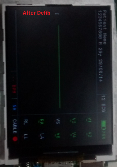

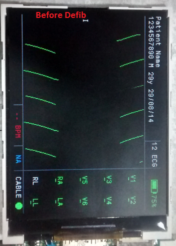

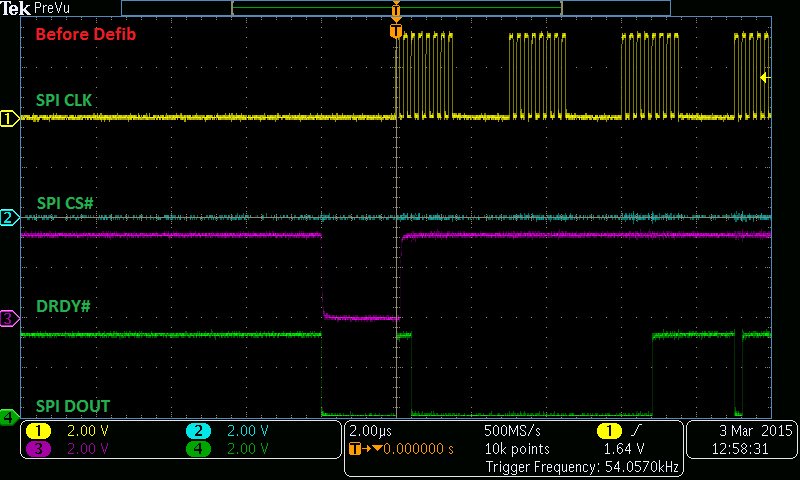

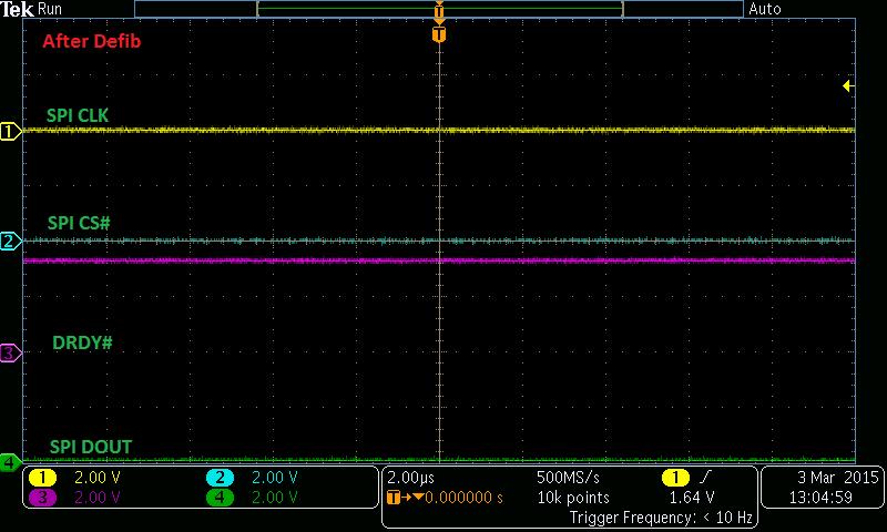

I am using ADS1198 (analog front end) in my project. when i apply a 5KV Defib pulse(in differential mode) on the input lines, AFE stops/freezes comunication with the controller. Resumes back only after system power off and power on.
Please suggest, what could be the possible reason for this and how to mitigate it

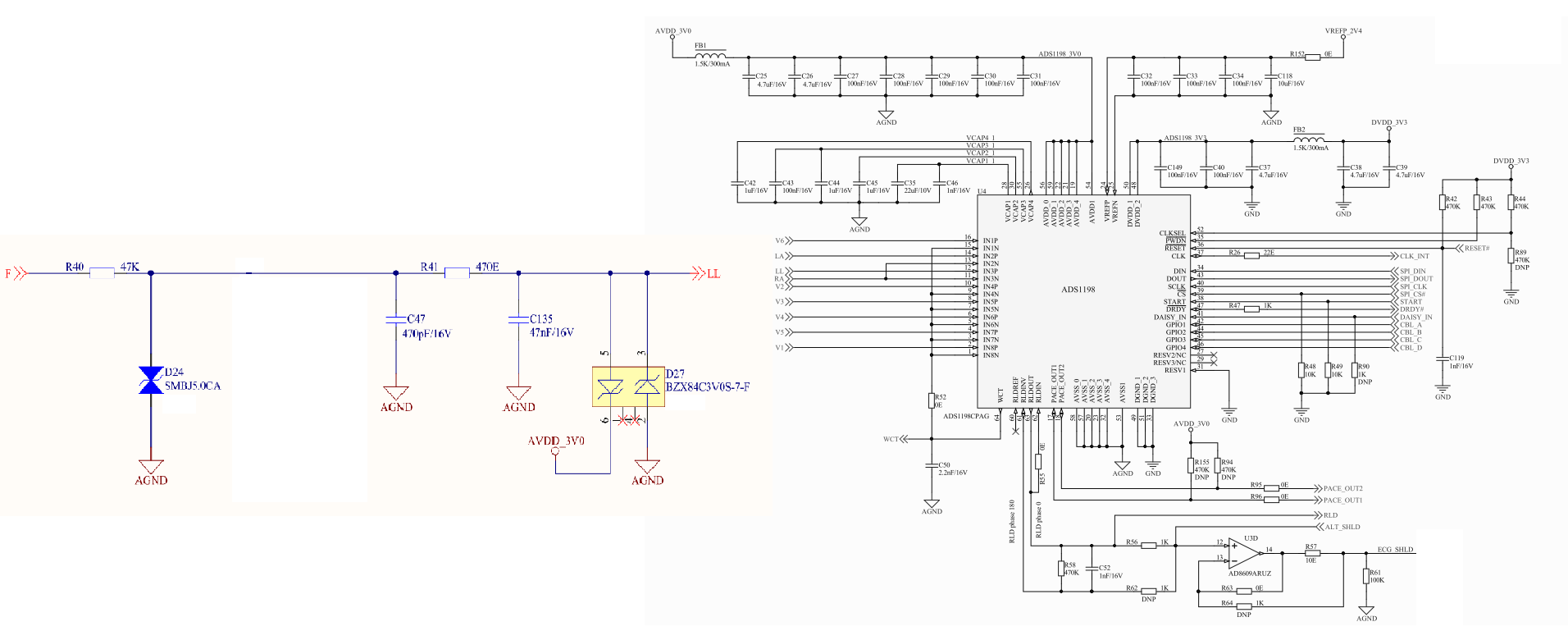

Attached is AFE input lines with defib protection circuit in my current design
