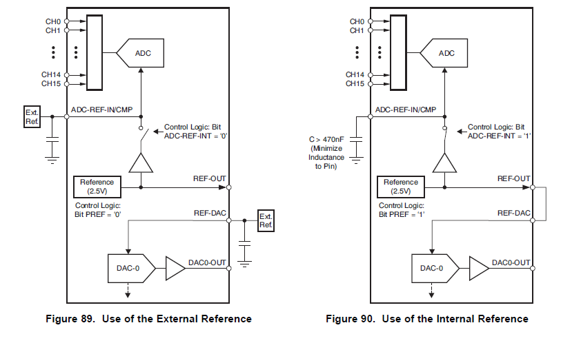

We just designed a prototype card with AMC7812, the main purpose is to use DAC output, so far we can communicate by I2C to the card but we have problem with DAC output, it always show 0 volts, ths DAC latch are written correctly, because just reading afer writing give us the correct value, but the physical ouptut still 0 volts. in our design we just pointed a minor difference with the AMC7812 EVM design the capacitor connected to AGND and REF-OUT (56) and REF DAC (57) was missing in our design , does this non existing capacitor can affect the DAC output ?

    The capacitor is generally recommended for additional noise filtering.  Are you using the internal reference? If so, there are a couple of registers you may need to set to fully activate the internal reference block.  You can do a quick check by measuring the voltage at REF-OUT.  If the voltage is not 2.5V, then the internal reference block is not enabled.
    When using the internal reference block, the PREF bit (bit 13 of 6Bh) should be set to '1', this activates the reference block which would then output the internal reference voltage to the REF-OUT pin.  The REF-OUT pin should connect to the REF-DAC pin as illustrated below.
    Matt

    We made more progress, in our design REF OUT and REF DAC are tied together, but was 0 volts on these line until we modfied register 0x6B with value 0X2000 (as you requested !), now we have 2.5 volts on the ref line wich is good, BUT still ave 0 volts on DAC output.

  • The sequence looks correct, there is just one register setting that you may be forgetting to set, but before I get to this I wanted to verify the following:
    register 0x59 value 0x0FFF
    The write above sets all DACs for a gain of 5XVref.  The default is 2xVref.
    The register 0x6B is also used to power all DACs, this information is found on page 80 of the DS.  For instance writing 0x3FFE to register 0x6B will activate all DACs with internal reference block.
    It should also be noted that this device has no required power sequence, but after entering power-up, a hardware reset is required to ensure specified device operation.  More information can be found in the Power-Supply Sequence section of the DS listed on page 49.
    Matt
  • Dear Matt,
    Yes the Gain of 5 is normal since we need 0-10 volts output, finally the solved solution comes from register 0x6B where we sent now 0x3FFE and the DAC works... great !! but some sample code will be welcome I think. We can continue our work, thanks alot.
