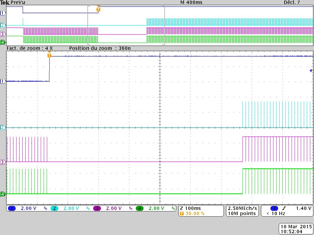

I'm encountering some issues with synchronization by PIN in pulse mode.
Sometimes, (around one time on 1000), synchronization doesn't work.
In normal case, I rise up my SYNC pin, then DRDY stops during 600ms (correct time according to datasheet) , and DRDY appears.
Example:
BLUE       (1) :       SYNC PIN
LIGHT BLUE(2):  SCLK
PURPLE (3) :       DRDY ADS 1
GREEN   (4) :      DRDY ADS 2
When error occurs, it looks like that :
The SYNC pin doesn't stop data, and doesn't synchronize converters.
The fact that the problem occurs on both converters makes me think that the problem should come from my initialization, but I don't understand where is the problem.
