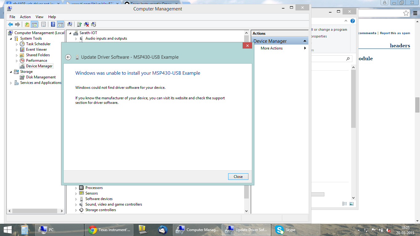

While trying to use the AFE4403EVM GUI the board is not getting detected. The USB driver is not installed properly, I tried installing it as mentioned in the reference manual and still it didnt work out. My OS is Windows 8 64bit and am attaching a Snapshot of the error.
Thanks in advance.

Hi amy, thanks for your help. I got that working,
