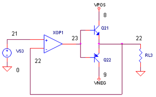

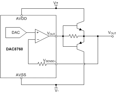

    This is what I had in mind:
    The external resistor placed in this design can be considered optional, the idea is that this will help reduce the cross-over distortion between when the PMOS and NMOS are active. In normal operation the DAC8760 output amplifier sources most of the current to the load, until the current pulled by the load causes the DAC8760 output amplifier output voltage to rise ultimately raising the Vbe of the two output transistors and allowing them to source the output current. The feedback node is taken from the other side of the bipolar transistors. Without the resistor the output amplifier just controls the Vbe voltages and allows the bipolar transistors to source the entirety of the current to the load while the output amplifier just watches the voltage across the load for feedback.

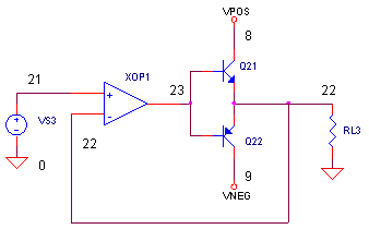

    You're referring to this circuit from the link you posted, correct?
    This circuit is basically the same as the one that I have suggested, except that they do not include the series resistor directly connecting the buffer output to the load. You would connect the VSENSE+ pin in the same way that I showed in the diagram I posted previously. VSENSE+ is the feedback path, so it goes to the feedback network and to the inverting input pin. I think this should answer the first part of your question?

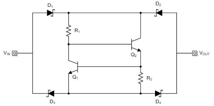

    Here's a current limiter I've built/tested previously with good success:
    Basically the default or primary path of current flow is always through Q2 and R2. Diodes D1, D2, D3, and D4 rectify this current path no matter what the polarity of the current flow is. When excessive current is flowing through Q2 and R2, the voltage drop across R2 raises which turns on Q1 and sort of "suffocates" Q2 creating our current limiter. Sizing R2 is all about where you want to place the current limit, sizing R1 is less scientific - it just needs to be small enough to ensure that during normal operation Q2 gets enough base current but still large enough to maintain the effectiveness of the current limit because as Q1 turns on we don't want to provide an alternative current path - we just want to choke Q2. I would suggest you just set the R2 value first then in SPICE muck with R1 until you get the behavior you want.
